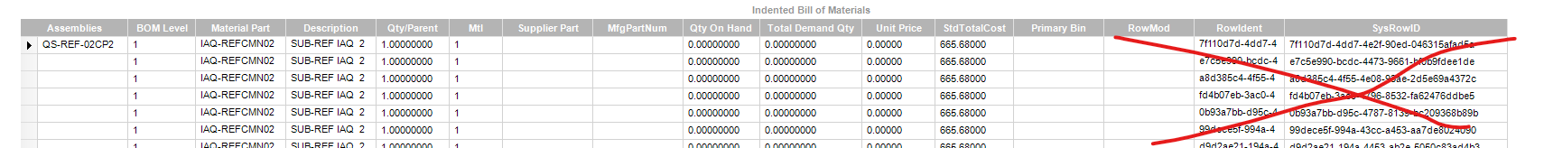

@Banderson No issue at all, I don’t expect you to read everything lol thats my job! I went back to what I originally had and I think I got it working. Now I believe I just need to edit my partition a little bit, because I realize that I didn’t account for multiple assemblies, so it doesn’t break those apart. I can get that working though(I believe), so I really only have one final question. I’m not really sure when, but it looks like these last three columns got put into my epigrid? Not sure where they came from, because they aren’t in my BAQ, and I would just like to get rid of them.

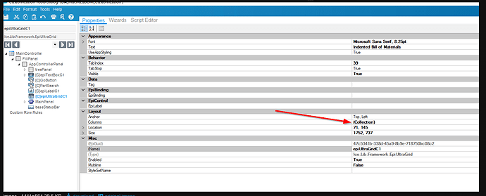

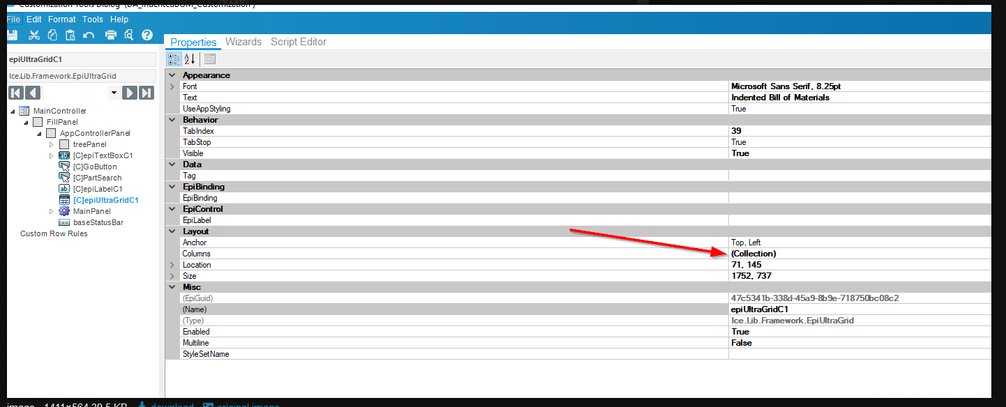

I don’t know all of the part you are using to make this, but, last resort in the customiztion (I’m assuming that’s where you are?) you can look at the collection if fields and check hidden and those will go away.
But they were probably added into your BAQ somewhere…
I must be missing something in my BAQ? I have 13 selected, which all 13 columns show up. Not sure where the last 3 come in at all.

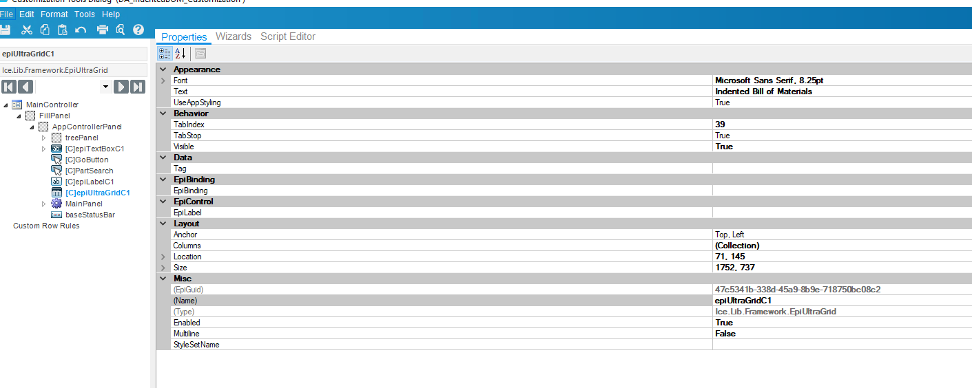

I’m not sure where I would go in there to hide those either?
Looks like this actually got added with me turning it into an updatable BAQ. Since I no longer need that I turned it off and we should be good now.
