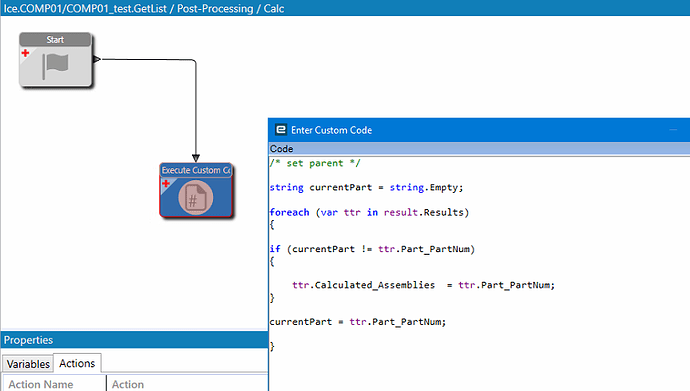

@Anthony_Mattice You can access the results in the baq post processing on getlist and set any fields.
@gpayne Could you give me some documentation on this or help me figure out how to add that to my returned list?
@Anthony_Mattice I would have just this simple piece of code in post processing of getlist.
/* set parent */
string currentPart = string.Empty;
foreach (var ttr in result.Results)
if (currentPart != ttr.Part_PartNum)
    ttr.Calculated_Assemblies  = ttr.Part_PartNum;
currentPart = ttr.Part_PartNum;
EDIT: If you ae 10.1 it is still ttResults

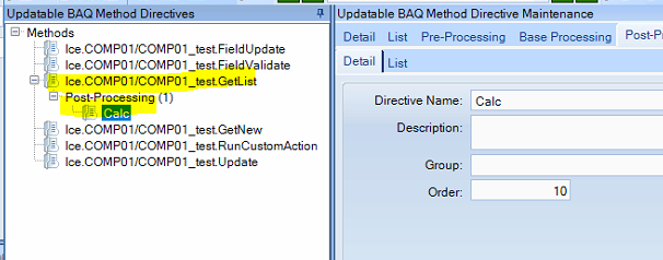

This is in the BAQ. If the BAQ is not updatable check it as updatable and then in update > update processing Set it as advanced BPM only.
Open BPM Directives Configuration.
This technique has been around since the E9 days to address things the query can’t quite pull off.
Do I keep my code the same in my BPM form designer? Also, do I remove my current calculated field - “Calculated_Assemblies”? Or what do I change that field to so that it still appears but nothing gets put in there from within the query.
And my bad for not knowing this stuff, still trying to get a handle on the design process around BAQs
And I’m also assuming I’ll need extra access for this as I don’t see it on my menu. What do I all need to have access for to do that?
Unless you are doing something else in the bpm form you don’t need any code there this is all done in the baq.
You need the field to put the value in. You can set a calculated field to single quotes for nvarchar or zero if it is decimal or int.
BAQ Advanced User will need to be set in your user.

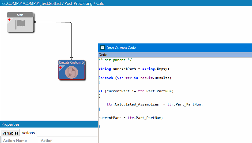

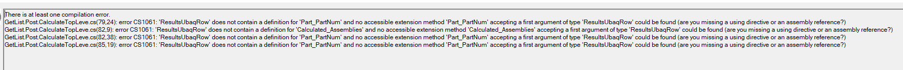

I created the post-processing path for this, but am receiving the following errors:
Does this mean my rows in my query aren’t setup right?
You just need to match up to your fields in the baq. Whatever the Part and Assemblies fields are is what you need. If you do not have the Part and now that I am thinking possibly the rev to know when to set the first column. If you do need the rev to be sure then current Part would be part and rev together.
I you want to post or DM me your baq I will send you the changes needed.

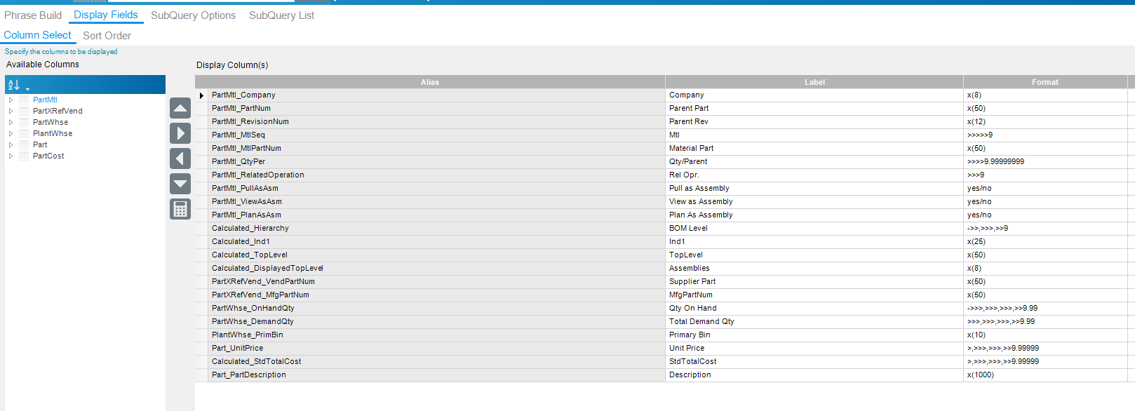

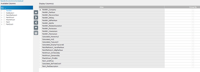

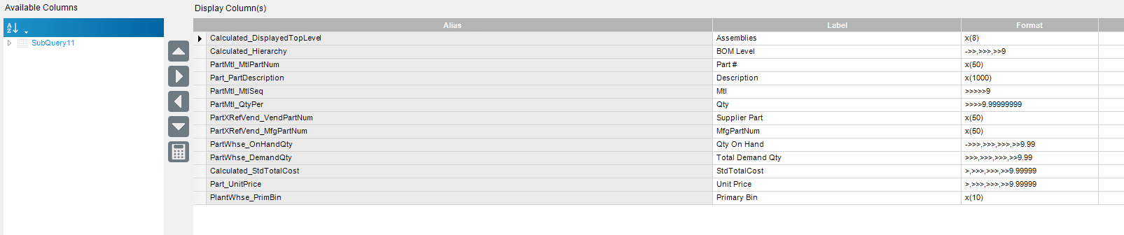

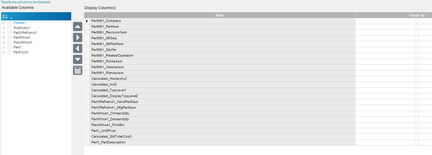

Ah ok, no issue at all I will post it. The first image is my CTE, second is Union, third is TopLevel. I also put the query below that, please let me know if there is more you need. Or let me know if you actually need the BAQ file.

with [SubQuery1] as
(select
	[PartMtl].[Company] as [PartMtl_Company],
	[PartMtl].[PartNum] as [PartMtl_PartNum],
	[PartMtl].[RevisionNum] as [PartMtl_RevisionNum],
	[PartMtl].[MtlSeq] as [PartMtl_MtlSeq],
	[PartMtl].[MtlPartNum] as [PartMtl_MtlPartNum],
	[PartMtl].[QtyPer] as [PartMtl_QtyPer],
	[PartMtl].[RelatedOperation] as [PartMtl_RelatedOperation],
	[PartMtl].[PullAsAsm] as [PartMtl_PullAsAsm],
	[PartMtl].[ViewAsAsm] as [PartMtl_ViewAsAsm],
	[PartMtl].[PlanAsAsm] as [PartMtl_PlanAsAsm],
	(1) as [Calculated_Hierarchy],
	(case
   when PartMtl.MtlSeq < 10 then cast(concat('000', PartMtl.MtlSeq) as nvarchar(25))
   when PartMtl.MtlSeq < 100 then cast(concat('00', PartMtl.MtlSeq) as nvarchar (25))
   when PartMtl.MtlSeq < 1000 then cast(concat('0', PartMtl.MtlSeq) as nvarchar (25))
 end) as [Calculated_Ind1],
	(PartMtl.PartNum) as [Calculated_TopLevel],
	(case
   when Hierarchy = 1 AND PartMtl.MtlSeq = 1 then(PartMtl.PartNum)
   when Hierarchy = 1 AND PartMtl.MtlSeq = 10 then(PartMtl.PartNum)
   else null
 end) as [Calculated_DisplayedTopLevel],
	[PartXRefVend].[VendPartNum] as [PartXRefVend_VendPartNum],
	[PartXRefVend].[MfgPartNum] as [PartXRefVend_MfgPartNum],
	[PartWhse].[OnHandQty] as [PartWhse_OnHandQty],
	[PartWhse].[DemandQty] as [PartWhse_DemandQty],
	[PlantWhse].[PrimBin] as [PlantWhse_PrimBin],
	[Part].[UnitPrice] as [Part_UnitPrice],
	(PartCost.StdLaborCost+ PartCost.StdBurdenCost+ PartCost.StdMaterialCost+ PartCost.StdSubContCost+ PartCost.StdMtlBurCost) as [Calculated_StdTotalCost],
	[Part].[PartDescription] as [Part_PartDescription]
from Erp.PartMtl as PartMtl
left outer join Erp.PartXRefVend as PartXRefVend on
	PartMtl.MtlPartNum = PartXRefVend.PartNum
left outer join Erp.PartWhse as PartWhse on
	PartWhse.PartNum = PartMtl.MtlPartNum
left outer join Erp.PlantWhse as PlantWhse on
	PartMtl.MtlPartNum = PlantWhse.PartNum
inner join Erp.Part as Part on
	PlantWhse.Company = Part.Company
	and PlantWhse.PartNum = Part.PartNum
left outer join Erp.PartCost as PartCost on
	PartCost.PartNum = PartMtl.MtlPartNum
where PartMtl.PartNum like @PartNum
union all
select
	[PartMtl1].[Company] as [PartMtl1_Company],
	[PartMtl1].[PartNum] as [PartMtl1_PartNum],
	[PartMtl1].[RevisionNum] as [PartMtl1_RevisionNum],
	[PartMtl1].[MtlSeq] as [PartMtl1_MtlSeq],
	[PartMtl1].[MtlPartNum] as [PartMtl1_MtlPartNum],
	[PartMtl1].[QtyPer] as [PartMtl1_QtyPer],
	[PartMtl1].[RelatedOperation] as [PartMtl1_RelatedOperation],
	[PartMtl1].[PullAsAsm] as [PartMtl1_PullAsAsm],
	[PartMtl1].[ViewAsAsm] as [PartMtl1_ViewAsAsm],
	[PartMtl1].[PlanAsAsm] as [PartMtl1_PlanAsAsm],
	(Calculated_Hierarchy + 1) as [Calculated_Hierarchy2],
	(case
   when PartMtl1.MtlSeq < 10 then cast(concat(Calculated_Ind1, '-', '000', PartMtl1.MtlSeq) as nvarchar(25))
   when PartMtl1.MtlSeq < 100 then cast(concat(Calculated_Ind1, '-', '00', PartMtl1.MtlSeq) as nvarchar(25))
   when PartMtl1.MtlSeq < 1000 then cast(concat(Calculated_Ind1, '-', '0', PartMtl1.MtlSeq) as nvarchar(25))
 end) as [Calculated_Ind2],
	(SubQuery1.Calculated_TopLevel) as [Calculated_TopLevel1],
	(case
   when Hierarchy2 = 1 AND PartMtl1.MtlSeq = 1 then(PartMtl1.PartNum)
   when Hierarchy2 = 1 AND PartMtl1.MtlSeq = 10 then(PartMtl1.PartNum)
   else null
 end) as [Calculated_DisplayTopLevel2],
	[PartXRefVend1].[VendPartNum] as [PartXRefVend1_VendPartNum],
	[PartXRefVend1].[MfgPartNum] as [PartXRefVend1_MfgPartNum],
	[PartWhse1].[OnHandQty] as [PartWhse1_OnHandQty],
	[PartWhse1].[DemandQty] as [PartWhse1_DemandQty],
	[PlantWhse1].[PrimBin] as [PlantWhse1_PrimBin],
	[Part1].[UnitPrice] as [Part1_UnitPrice],
	(PartCost1.StdLaborCost+ PartCost1.StdBurdenCost+ PartCost1.StdMaterialCost+ PartCost1.StdSubContCost+ PartCost1.StdMtlBurCost) as [Calculated_StdTotalCost1],
	[Part1].[PartDescription] as [Part1_PartDescription]
from Erp.PartMtl as PartMtl1
inner join  SubQuery1  as SubQuery1 on
	PartMtl1.PartNum = SubQuery1.PartMtl_MtlPartNum
	and PartMtl1.Company = SubQuery1.PartMtl_Company
inner join Erp.PartXRefVend as PartXRefVend1 on
	PartXRefVend1.PartNum = PartMtl1.MtlPartNum
inner join Erp.PartWhse as PartWhse1 on
	PartWhse1.PartNum = PartMtl1.MtlPartNum
inner join Erp.PlantWhse as PlantWhse1 on
	PartMtl1.MtlPartNum = PlantWhse1.PartNum
inner join Erp.Part as Part1 on
	PlantWhse1.Company = Part1.Company
	and PlantWhse1.PartNum = Part1.PartNum
inner join Erp.PartCost as PartCost1 on
	PartCost1.PartNum = PartMtl1.MtlPartNum)
select
	[SubQuery11].[Calculated_DisplayedTopLevel] as [Calculated_DisplayedTopLevel],
	[SubQuery11].[Calculated_Hierarchy] as [Calculated_Hierarchy],
	[SubQuery11].[PartMtl_MtlPartNum] as [PartMtl_MtlPartNum],
	[SubQuery11].[Part_PartDescription] as [Part_PartDescription],
	[SubQuery11].[PartMtl_MtlSeq] as [PartMtl_MtlSeq],
	[SubQuery11].[PartMtl_QtyPer] as [PartMtl_QtyPer],
	[SubQuery11].[PartXRefVend_VendPartNum] as [PartXRefVend_VendPartNum],
	[SubQuery11].[PartXRefVend_MfgPartNum] as [PartXRefVend_MfgPartNum],
	[SubQuery11].[PartWhse_OnHandQty] as [PartWhse_OnHandQty],
	[SubQuery11].[PartWhse_DemandQty] as [PartWhse_DemandQty],
	[SubQuery11].[Calculated_StdTotalCost] as [Calculated_StdTotalCost],
	[SubQuery11].[Part_UnitPrice] as [Part_UnitPrice],
	[SubQuery11].[PlantWhse_PrimBin] as [PlantWhse_PrimBin]
from  SubQuery1  as SubQuery11
order by SubQuery11.Calculated_TopLevel, SubQuery11.Calculated_Ind1

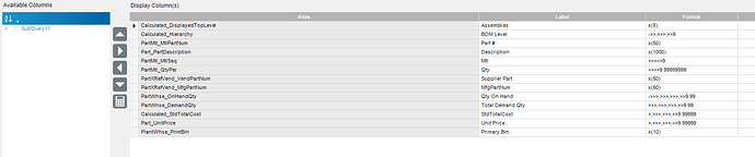

Use PartMtl_PartNum and Calculated_DisplayedTopLevel

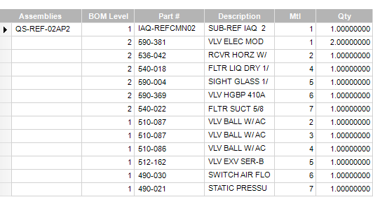

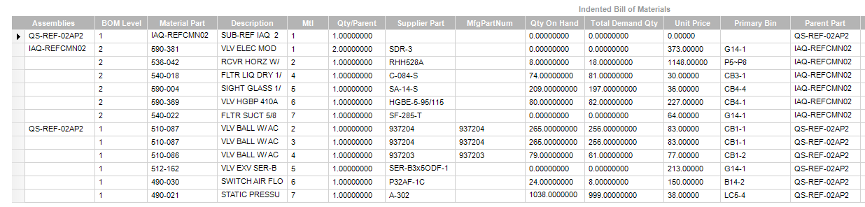

That seems to have gotten the errors to go away. When I do the query now, I get this. It doesn’t seem to only put the assembly down for the first part, and it also is putting its part number instead of its parents part number. I’m assuming this is because I used PartMtl.MtlPartNum. When I tried using PartMtl_PartNum, I got an error, so I’m assuming I will have to display the parent part in a row?

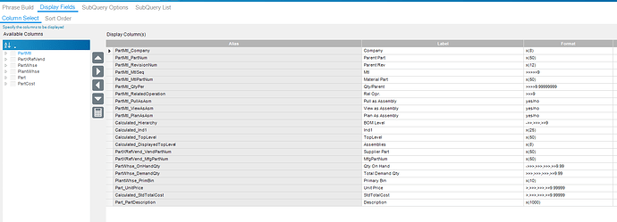

You will need the parent part in a row in the baq to set the calculated field, but you will not have to show it in the dashboard.

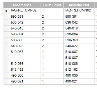

This is where it is at now. Changed everything back to PartMtl_PartNum, and added the parent part row.
So from here, not sure why it is displaying the “IAQ” sub assembly in there, and it is duplicating the top level
