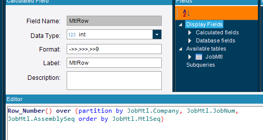

Yeah, just make a calculated field and use that instead of your material sequence that you were using, then you should be able to just adjust from met seq 10 and use the number 1 with what you already had going on with your query before you noticed the discrepancies.
So you get this something like this. I don’t have any multi level BOMs in this data base, but you get the idea. Even though the MTL seq starts with a 5, the first one is still 1.
This is the calculated field

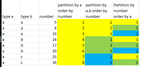

I was just using the jobMtl table, and that’s how you would do it there. You’ll need to decide how to partition in in whatever tables you are using, I was just giving you the basic tool to be able to do it.
This is the basics of what a ā€œPartitionā€ is. Basically, any time any on of the partition changes, the grouping starts over. And you can combine them so that any piece of the partition changes, the row number starts over. So if the excel example, you can see the row numbers that you would get. I changed the color for every time the rows start over.
So choose your partitions so that they start over as necessary. If you are using a recursive query, I’m assuming that they will start over with each recursion.
