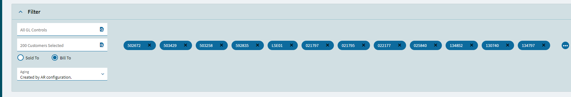

Has anyone seen an issue with Quick Searches and BAQ’s searches only pulling through 50 records compared to when you do a normal search and select the records that appear, you can get 200 by default
Is there a setting somewhere that i am missing or is this a bug/“Feature” in 2022.2

But as soon as i use normal search and select the records, i get 200

When i use it in Customer Search in Classic, it pulls through 10,213 rows
