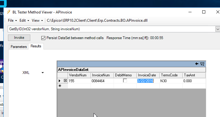

interesting, the adapter has a the APInvoice head date in there…
