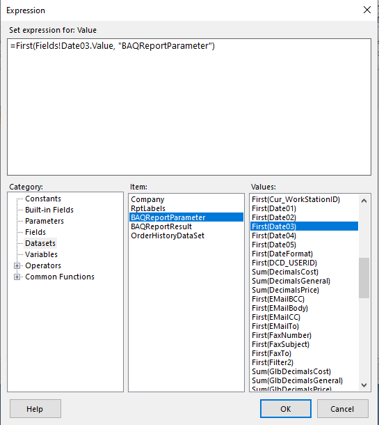

in your parameter expression just write
=First(Fields!Option01.Value, "BAQReportParameter")

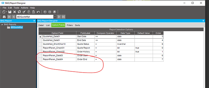

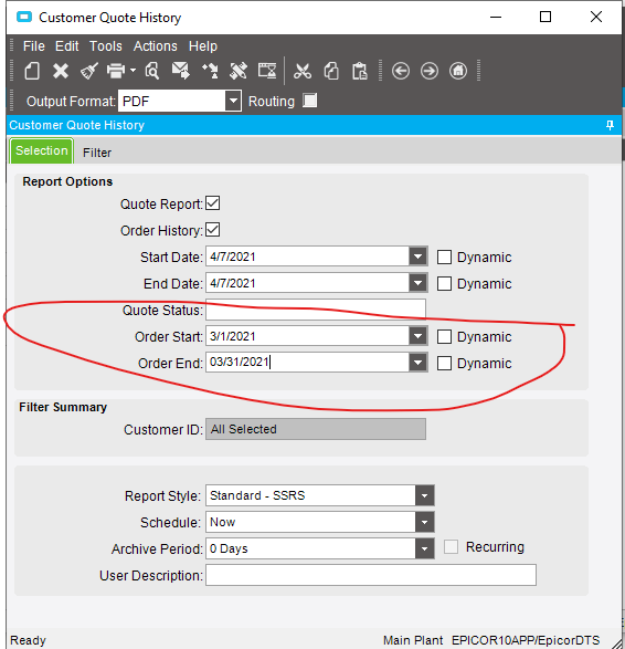

I have been working with Aaron on this issue. To define this more precisely we are attaching a dataset from a SQL view to this BAQ SSRS Report that we are trying to filter using the BAQ Report Parameters we are setting up in the Option Fields,
So that when we run this report from E10 we can enter different dates for the BAQ report and the SQL View dataset(s), other view datasets to be added if we can get this to work.

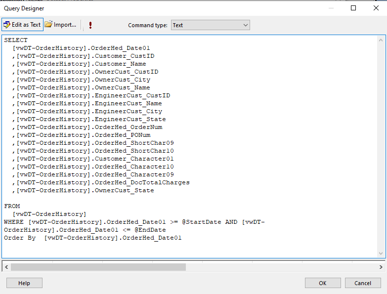

We tried several examples by @josecgomez and others to get the filter working in the SQL View via SSRS Query Designer using a Where statement. Never got a filtered result from the SQL View dataset in the report.

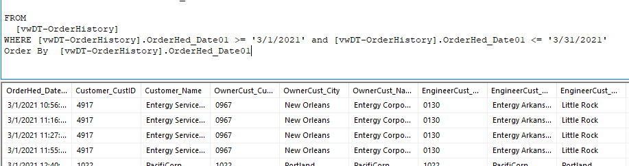

We tried a hard date in the SQL statement for the view and the result in the SSRS Query Designer and get the correct result,
But if we run the report via the test report with these hard dates in the SQL View dataset Where statement we get the entire dataset in our result not the filtered result in the SSRS Query Designer.

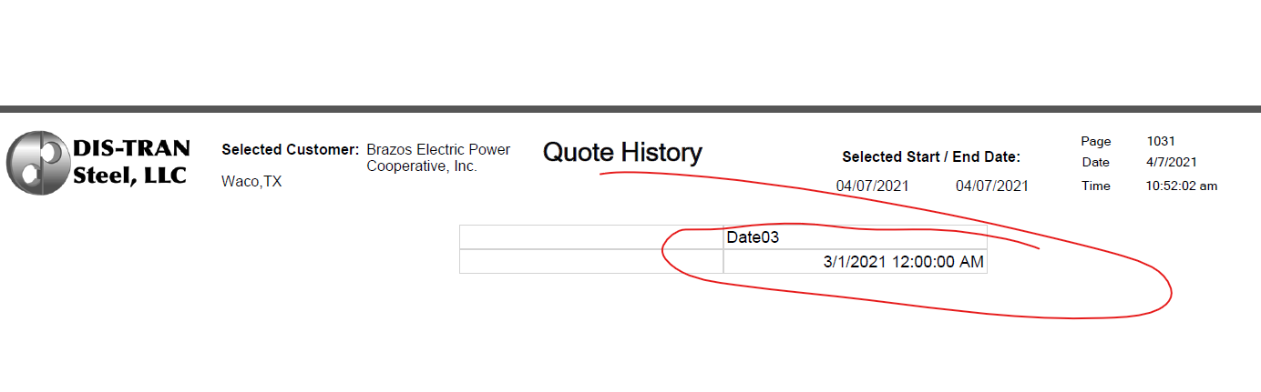

We were able to display the ReportParam_Date03 on the report so we know they are getting through.
If you can print the field then you are getting it , all you need to do is pass down those fields into the subreport

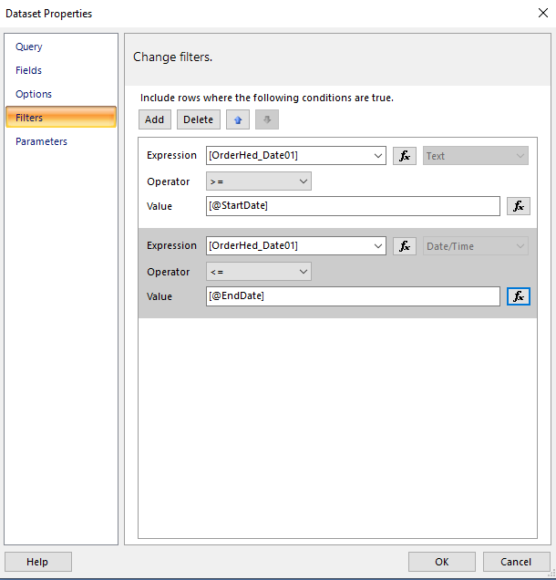

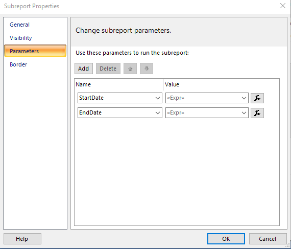

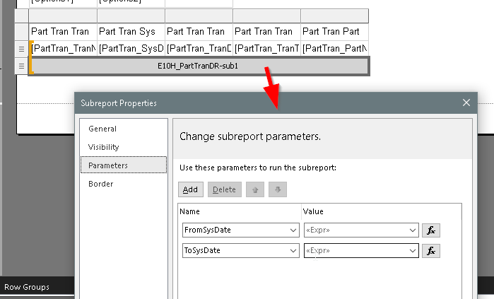

Just to make sure we are on the same page. I went into the Subreport Properties and added the parameter shown below with “StartDate” being tied to the expression below. “EndDate” is tied to a similar expression but to Date04 instead.
I then went into my subreport’s Dataset Properties and removed the Where statement from the query and added this filter. OrderHed_Date01 is the date field in the subreport that we are trying to filter using the inputs from Date03 and Date04.

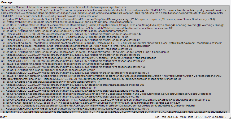

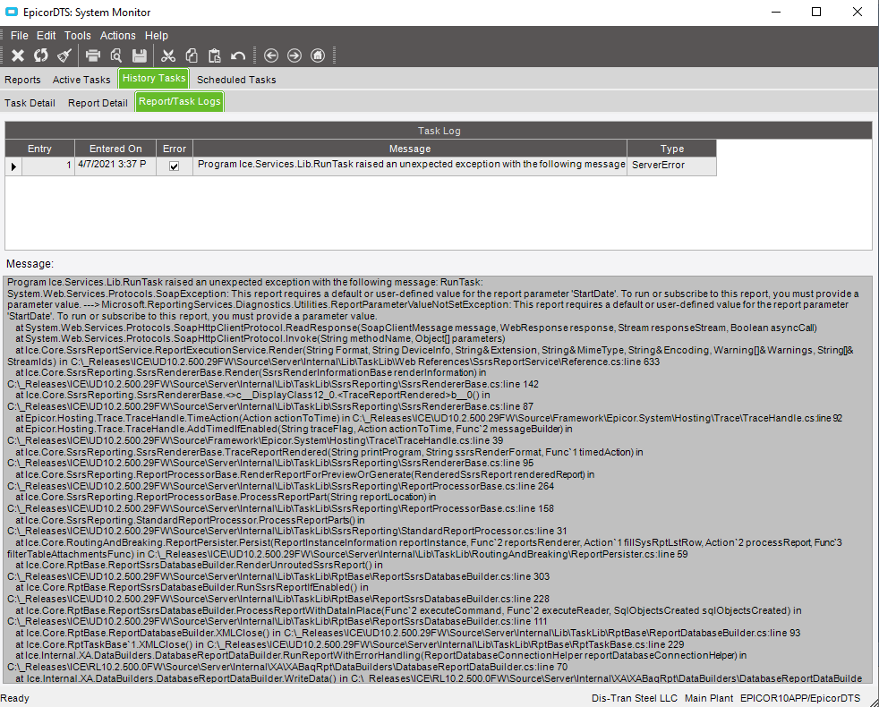

After that I ran into this:

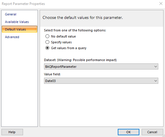

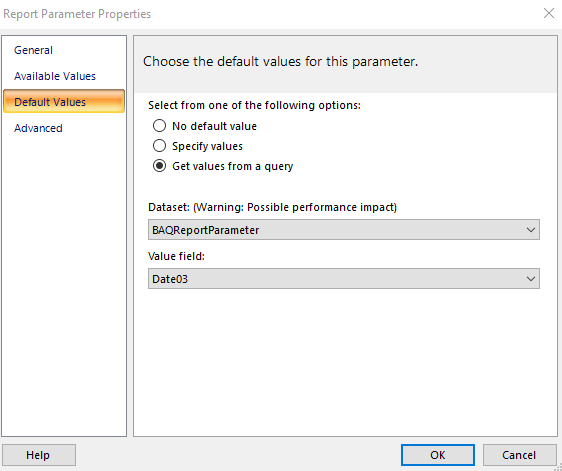

So I went into the Report Parameter Properties and added default values to the “StartDate” and “EndDate” parameters.
And tested the report again and got this:

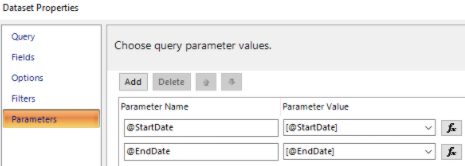

If you have verified that the Parameter shows in the subreport, then you should be able to filter by adding the parameters in your Subreport’s dataset

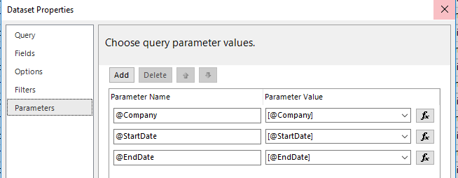

Then should be able to reference them in your subquery’s query expression with @ signs

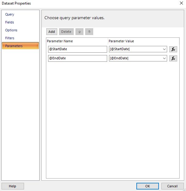

I am pretty baffled at this point because it should work. This is the code in my dataset query and the query parameters I added.
And I have the parent report parameters set up this way with both the default and available values set to Date03 for the @StartDate parameter and Date04 for @EndDate.

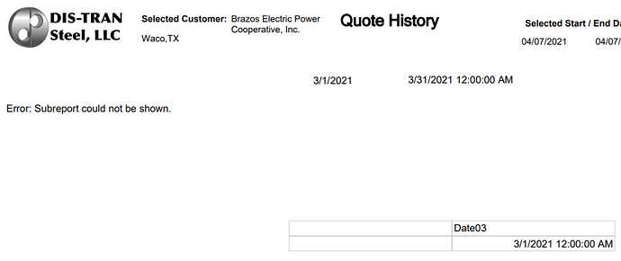

I am now consistently getting the error message: “Error: Subreport could not be shown.” when I test my report.
Do you need to create parameters EndDate and StartDate in the parent report?

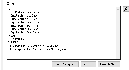

  • The subreport’s dataset query should reference those parameters. Like:
  • The subreport object in the main report, should have the two parameters:
    Those names are from parameters setup in the subreport.
    The expressions should be: =First(Fields!Option01.Value, "BAQReportParameter")
I have tried your suggestion, but now when I run my test report I keep getting this error.

I have gone back in my subreport and only added the parameters “StartDate” which is tied to Date03 in my main report and “EndDate” which is tied to Date04. When I run the report I get this new message that I haven’t seen before.

This is where the @StartDate and @EndDate parameters populated before:
I feel like I am going in circles because if I add them back to my dataset then they auto populate back in that Parameter folder and I am running into the same errors.
