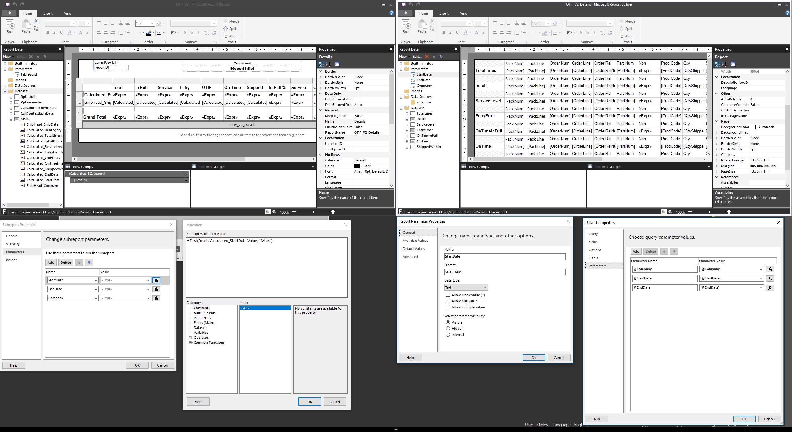

StartDate & EndDate need added to the subreport RDL. Just add the name, and datatype. Nothing else
@ckrusen because I have separate reports that I am trying to bring into this main report. Would it be easier to just remake the tables in this report and do the filtering that way?
Main report on the left, subreport on the right. Subreport can then use the parameters in the dataset
WHERE T1.FieldName = @StartDate

Insert your subreport into the parent. While editing the Parent, select the subreport and view itâs properties.
In the subs properties, set it like
But hardcode values into the Paramter values. Preferably the same ones you used when testing the subreport by itself.
Make sure your hardcoded expression returns the proper type.
Like =CDate("04/20/2021")

If I may borrow Finleyâs screenshot âŚ
Okay I added that and tested the report in the BAQ Report Designer and getting this error again:
In the Subreport Properties dialog (shown above), the dropdown under the Name column shows the parameters that the actual subreport RDL has defined?
Yes
One last thing to try ⌠In the subreport RDL, create defaults for the parameters, enter fixed dates, such that they donât filter any data. Like the default for StartDate being 1/1/2000, and the one for end date being 12/31/2021. Test run the subreport by itself in Report Builder. Does it run without prompting or generating any errors?
