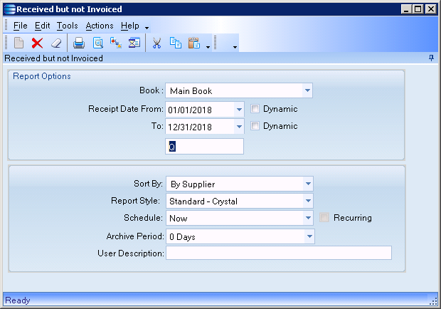

This is the standard report where i want a “begins with” option adding

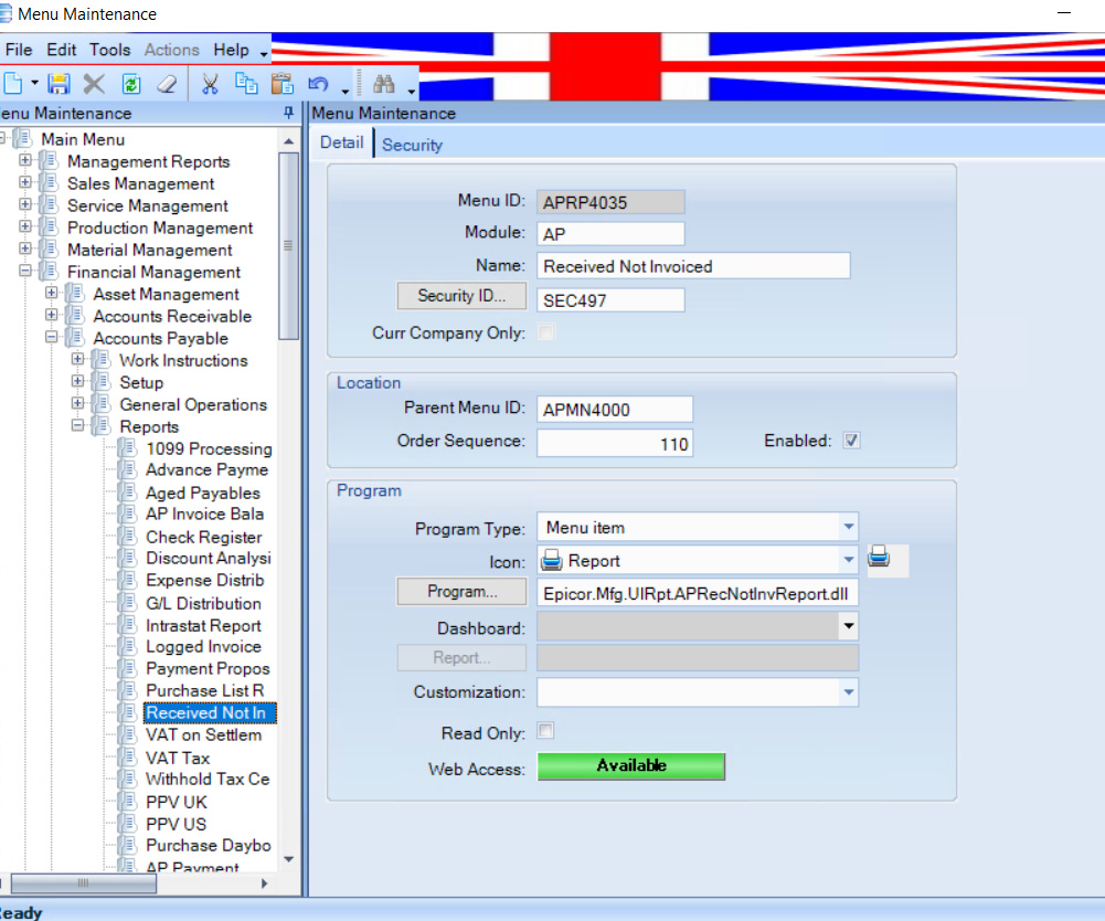

this screenshot is of menu tree maintenance.
I think this is the report style for it…
But where can i add the new OPTION if i can’t find this in BAQ report designer?

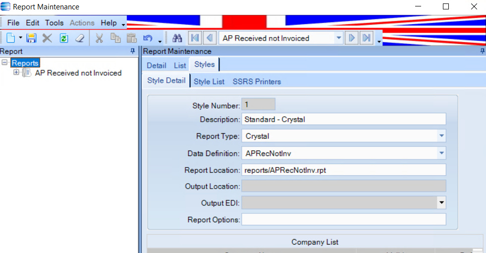

ok, i’ve jumped ahead a bit …
i couldn’t find the BAQ report designer so instead i’ve gone down this route.
  1. create a new report style.
  2. edit the crystal report to only bring through items where the VendorID begins with Q.

I do see that the RcptsNotInv within the BAQ Report Designer does not seem to be linked to the actual Received but not Invoiced report…
I would think that the best solution is to create a Customization on the Report Options form for the Received but not Invoiced report but I’m not exactly sure how to get that working:
