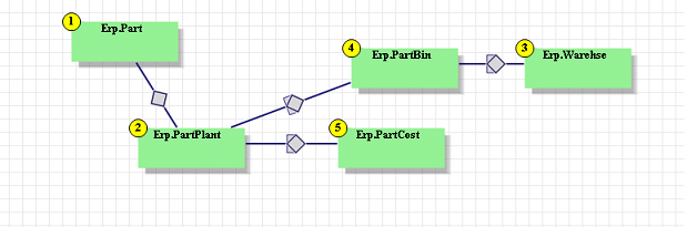

Here’s the graphic of my BAQ

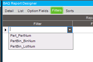

And here’s what is available for Filter fields in the BAQ Report Designer
Are filters only limited to the first two tables?
My end goal is to have a filter for the Plant Name, on the Report window.
You can only filter on fields you are displaying on the bAQ>
But I’m displaying many more fields than are shown in the BAQ Report Designer filter option

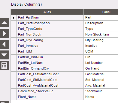

Here’s the fields being displayed:

What’s that “cross join” in the query I posted above?
In the GUI phrase builder GUI, all the join types show as “inner”
Could it be from my attempt to reorder the tables?
I had moved table Plant from #5 to #2 (originally thinking that the filter was limited to the first two tables)
The filters will be having only for Key Fields of the BAQ tables.
Cross join means you have a screwed up join in your BAQ.
I think you can only filter for fields that have a “code base” like part
num, cust ID, etc.
For other fields you can add options from the BAQ report writer, but then
you have to go into the SSRS report and filter them. It’s a little less
automagic.
Joe
Add Plant ID to the Display List then you can filter by that, sorry I didn’t realize you were using Plant_Name, just add plant List and filter that way
I re-reordered the tables and the cross join went away. But the original problem still exists (as it did before the original re-ordering that created the cross join)
I added Plant.Plant as a displayed field, but it still doesn’t show.
Is it because the Plant table does not have a direct connection to the Part Table?
No that shouldn’t matter Plant_Plant should show up… in your BAQ add all those fields to LIKE column…

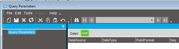

In the BAQ, open Actions - Define Parameters.
I looked there. the list is empty.

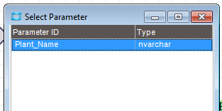

If add a Table Criteria of type “specified parameter”, and then click the “specified” link
I get:
Seems that Plant_Name parameter is FUBAR’d.
If I try to make a new Query Parameter (from Actions \ Define Parameters) and name it Plant_Name, it says it already exists. Yet it doesn’t show in the Query Parameters window.

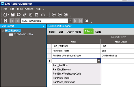

Not sure what data you want returned but…here are a couple screen shots, quick example with some of the same tables
and where the plant is listed in the BAQR filters.
