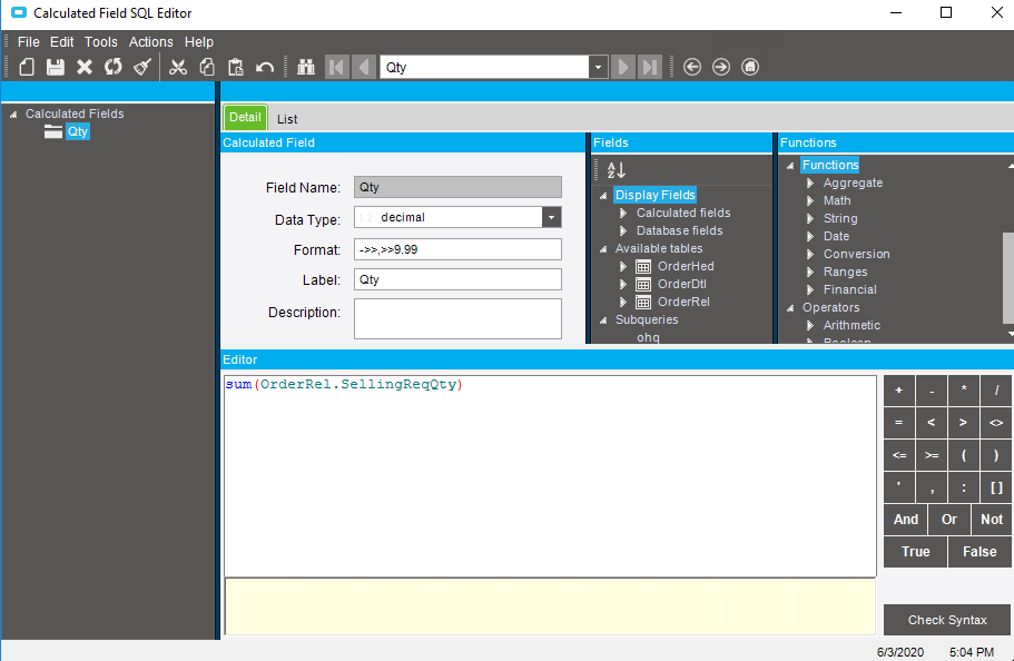

I see a sql reference on the “inter-web” SUM (Fields.OrderDtl.Qty.Value) OVER (ORDER BY Fields!OrderDtl.OrderNum.Value) AS RunningQtyTotal
can that be done in the BAQ environment?
DaveO
Yes it can, as a calculated field.
I’ve used something similar to get a running total of inventory over time:
SUM(ActTransQty) OVER (PARTITION BY PartTran.PartNum ORDER BY PartTran.TranNum ROWS BETWEEN UNBOUNDED PRECEDING AND 1 PRECEDING)
