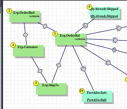

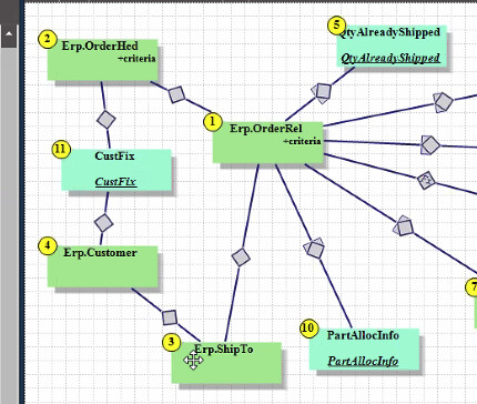

BAQ sql runs in SSMS in 3 seconds, over 7 minutes in epicor
So, we are struggling with a BAQ (an ugly one) that does a bunch of calculations and whatnot. If I run the BAQ from within epicor, it takes over 7 minutes to finish (if it finishes). I can grab the query that’s being run from SQL, and wire up the territory stuff and other parameters that’s being used to run it, and it runs in 3 seconds.
We’ve added option (recompile), re-indexed the applicable tables, and recycled the appservers, copied the query, changed inner subs to CTEs, but we still can’t figure out why when running this BAQ in epicor it takes so long, while we can run it in SSMS and it’s only a few seconds.
Grasping at straws here for someone with any ideas.
Here’s the query phrase from the general tab, not that I think it will help.
 * Disclaimer!!!
 * This is not a real query being executed, but a simplified version for general vision.
 * Executing it with any other tool may produce a different result.

I know there’s a disclaimer at the top of the General query phrase, but looking at it, there’s a section that looks like this
inner join Erp.ShipTo as ShipTo
	and
	Customer.Company = ShipTo.Company
	and Customer.CustNum = ShipTo.CustNum
which looks like a goofed up join. It’s most likely nothing, but it caught my eye.
Yeah, it’s goofy. But I need the ship to, and the OrderRel only has the ship to and not the customer numbers. But the shipto ID needs the custnum. So you get this dumb join.
I’m not a fan of circular joins.

Can’t you use the ShipToCustNum field in OrderRel for customer?
Real Housewives Table Flip GIF
Finally!!! I was looking for CustNum and forgot to add the * for the wild card.
Yeah, that will work. I can get rid of that goofy join now.
One thing @josecgomez did, was add the customer table as a CTE, removed the original one, then it ran fine. Then he put it back, and now the original setup, (mostly) is working fine. Something is getting stuck there.
Then we just added the Customer table as a CTE, and put it in between these two, and now it’s working.
Why do you need the Customer table at all?
It’s the only place to get the customer name.
Not for SaaS Cloud customers last I checked.
