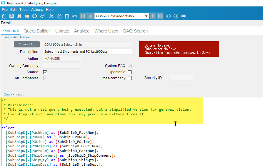

The query displayed in the BAQ screen is not what is ran in reality. Add a filter on Part.Company in the top query and it should help fixing your issue.
See the disclaimer added in 10.2.400.
Oh wow - not see that in 10.2.400, BUT you were totally right.
Adding that Part.Company filter in the top level BAQ solved it. Now runs in < 1 sec as per SSMS.
What gives? What is the explanation for that working? Thanks!
