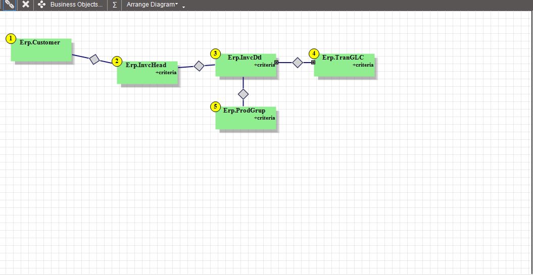

What do you think on this:
[Customer].[Zip] as [Customer_Zip],
[Customer].[Country] as [Customer_Country],
[Customer].[PhoneNum] as [Customer_PhoneNum],
[InvcHead].[InvoiceDate] as [InvcHead_InvoiceDate],
[InvcHead].[InvoiceType] as [InvcHead_InvoiceType],
[InvcHead].[FiscalYear] as [InvcHead_FiscalYear],
[InvcHead].[FiscalPeriod] as [InvcHead_FiscalPeriod],
[InvcDtl].[ExtPrice] as [InvcDtl_ExtPrice],
[InvcDtl].[DocTotalMiscChrg] as [InvcDtl_DocTotalMiscChrg],
[InvcDtl].[PartNum] as [InvcDtl_PartNum],
[InvcDtl].[LineDesc] as [InvcDtl_LineDesc],
[InvcDtl].[SellingShipQty] as [InvcDtl_SellingShipQty],
[InvcDtl].[SalesUM] as [InvcDtl_SalesUM],
[TranGLC].[SegValue2] as [TranGLC_SegValue2],
[InvcHead].[InvoiceNum] as [InvcHead_InvoiceNum]
from Erp.Customer as Customer
inner join Erp.InvcHead as InvcHead on
Customer.Company = InvcHead.Company
And
Customer.CustNum = InvcHead.CustNum
and ( InvcHead.InvoiceType <> ‘DEP’ and InvcHead.InvoiceType <> ‘ADV’ and InvcHead.Posted = TRUE )
inner join Erp.InvcDtl as InvcDtl on
InvcHead.Company = InvcDtl.Company
And
InvcHead.InvoiceNum = InvcDtl.InvoiceNum
and ( InvcDtl.ExtPrice <> 0 )
inner join Erp.TranGLC as TranGLC on
InvcDtl.Company = TranGLC.Company
And
InvcDtl.InvoiceNum = TranGLC.Key1
And
InvcDtl.InvoiceLine = TranGLC.Key2
and ( TranGLC.RelatedToFile = ‘InvcDtl’ and TranGLC.SegValue2 >= ‘10’ and (TranGLC.SegValue1 = ‘40000’ or TranGLC.SegValue1 = ‘40300’ ) )
inner join Erp.ProdGrup as ProdGrup on
InvcDtl.Company = ProdGrup.Company
And
InvcDtl.ProdCode = ProdGrup.ProdCode
and ( ProdGrup.ProdCode = ‘226’ or ProdGrup.ProdCode = ‘226B’ or ProdGrup.ProdCode = ‘226C’ )
Will,
Your joins are good, a few changes I would try to see if it helps, make a copy first:
  1. Use an IN operator on the ProdGrup.ProdCode instead of OR’s
  2. For the InvcHead.InvoiceType you can use NOT and the IN Operator instead of the two AND’s
  3. You are hitting the TranGLC table, one of the larger tables in the DB, that will be expensive no matter what, but the joins look ok.
  4. See if it is reasonable to limit the results to a shorter time period, sometimes that can help especially if they only need YTD or last 12 months or something, especially as time progresses. Eventually the network transport cost becomes higher than the query cost.
    You could play around with the order of the joins, while the query optimizer is supposed to construct the best execution plan, sometimes you can get better performance by moving the most limiting criteria towards the top, however this can also sometimes yield an unintended data set. If you are including a table just for referenced data (like customer) you can usually move it down.

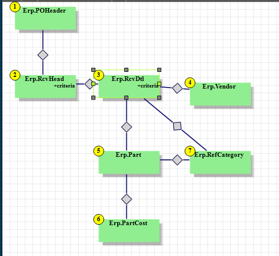

@danbedwards
What do you think of mines? How could i speed this up?
select
[Vendor].[VendorNum] as [Vendor_VendorNum],
[Vendor].[Name] as [Vendor_Name],
[POHeader].[PONum] as [POHeader_PONum],
[Part].[PartNum] as [Part_PartNum],
[Part].[PartDescription] as [Part_PartDescription],
[POHeader].[OrderDate] as [POHeader_OrderDate],
[RcvDtl].[ReceiptDate] as [RcvDtl_ReceiptDate],
[RcvDtl].[VendorQty] as [RcvDtl_VendorQty],
[RcvDtl].[VendorUnitCost] as [RcvDtl_VendorUnitCost],
[Part].[RefCategory] as [Part_RefCategory],
[RefCategory].[Description] as [RefCategory_Description],
[RcvDtl].[PartNum] as [RcvDtl_PartNum],
[RcvDtl].[PartDescription] as [RcvDtl_PartDescription]
from Erp.POHeader as POHeader
inner join Erp.RcvHead as RcvHead on
POHeader.Company = RcvHead.Company
and POHeader.PONum = RcvHead.PONum
and ( RcvHead.Plant = ‘MfgSYs’ )
inner join Erp.RcvDtl as RcvDtl on
RcvHead.Company = RcvDtl.Company
and RcvHead.VendorNum = RcvDtl.VendorNum
and RcvHead.PurPoint = RcvDtl.PurPoint
and RcvHead.PackSlip = RcvDtl.PackSlip
and ( RcvDtl.ReceiptDate >= ‘03/01/2020’ and RcvDtl.ReceiptDate <= ‘03/31/2020’ )
inner join Erp.Vendor as Vendor on
RcvDtl.Company = Vendor.Company
and RcvDtl.VendorNum = Vendor.VendorNum
inner join Erp.Part as Part on
RcvDtl.Company = Part.Company
and RcvDtl.PartNum = Part.PartNum
inner join Erp.PartCost as PartCost on
Part.PartNum = PartCost.PartNum
inner join Erp.RefCategory as RefCategory on
RcvDtl.Company = RefCategory.Company
and
Part.Company = RefCategory.Company
and Part.RefCategory = RefCategory.RefCategory
I don’t like the three way join between RcvDtl, Part, and RefCategory…
Also, your join to the partcost table doesnt have a Company field join, which it should have. Also, the primary key to PartCost also needs a CostID. On many systems, the only cost ID is “1”, but Epicor supports multiple cost ID’s, so if you do as well, you also need to look in the Plant table to find out which cost ID you are using…
Assuming a cost ID of 1, you need to add a table criteria of CostID = 1
