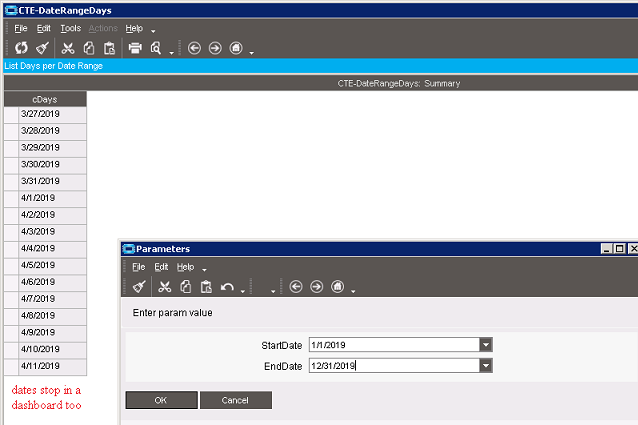

Two date params, one is StartDate, one is EndDate. Put the StartDate param on the date field of your table and do >=, put the EndDate param on the same field (with AND) and do <=.
Still… I liked the example
I’m thinking I can get away with a months worth of days.
but… I see farther down in that thread there is a workaround if I need it.
Thanks…
