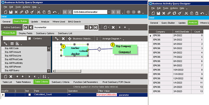

Not sure what error you were getting
but I was seeing a maximum recursion error.
So… I added a NumberOfMonths parameter to limit the count (12 in this example = 13 rows)…
TBD if that would apply on your end?
That was it! On my end, it just says Bad SQL statement and to look at the server event logs. Being on the cloud we are not allowed access to those. Limiting my recursions to 12, which equals 12 months, we got all our results the way they should be! Thanks Bruce !!!
