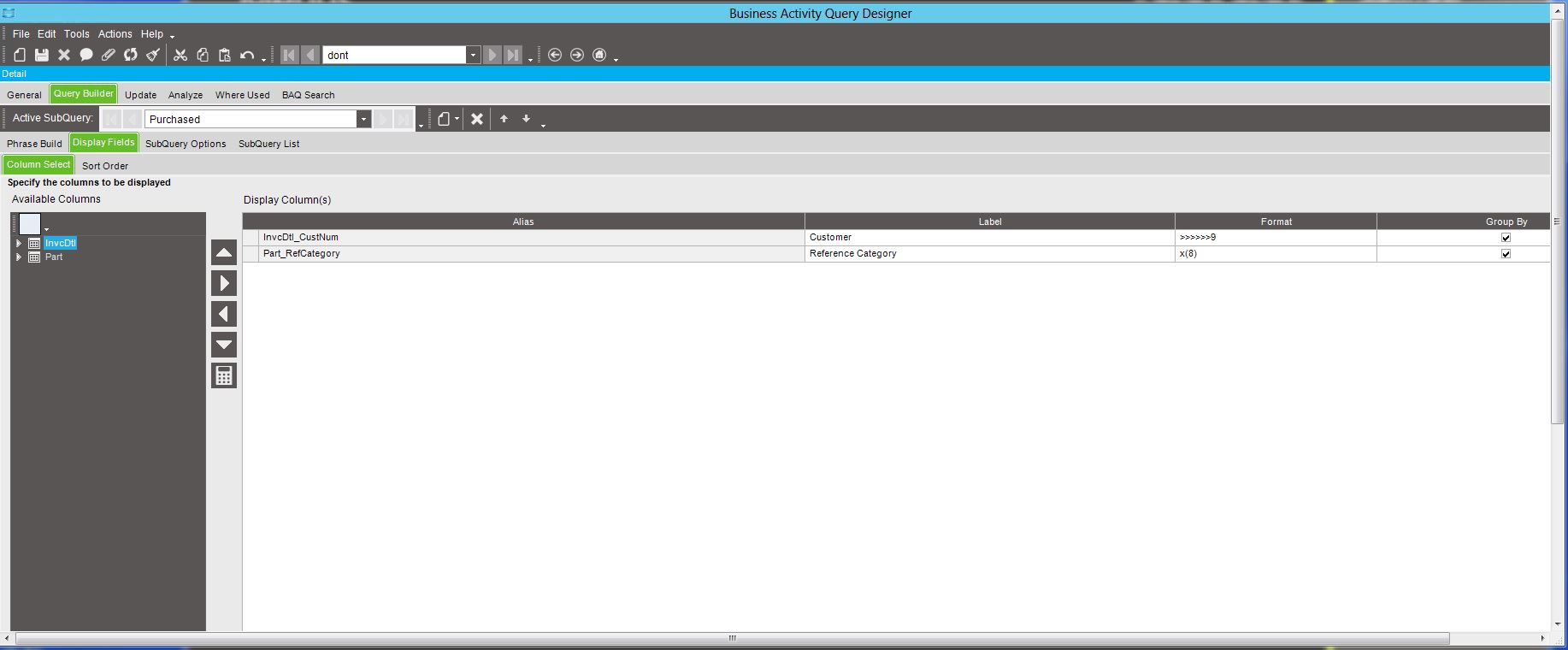

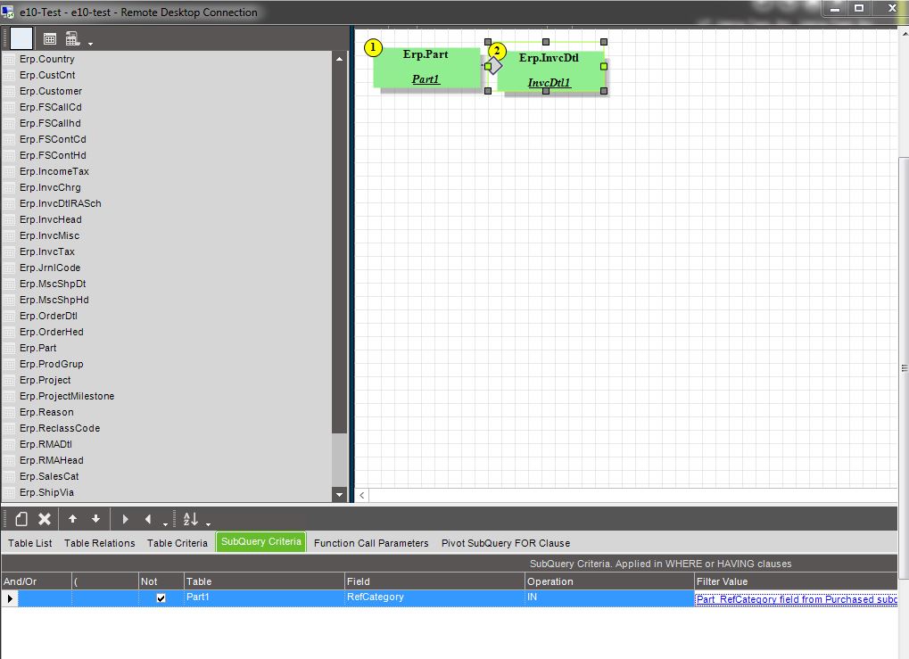

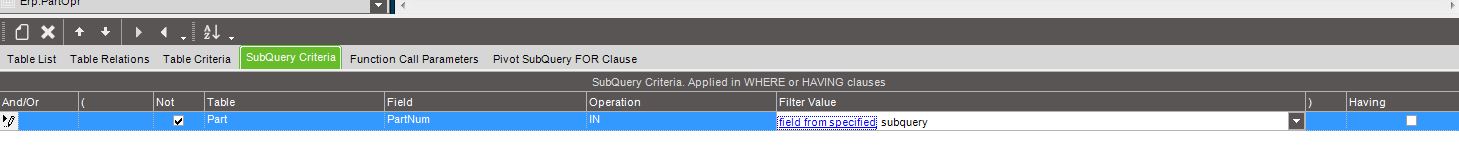

Specifically, I needed to group parts and due ot how things were set up before I came on-board, in testing it was easier to just use the Part Reference since it was not being used. So I created 13 groups and grouped the parts accordingly. Then I have Part–>InvcDtl–>Customer and my BAQ. Display fields are CustId and refCategory. I tried to i use a Sub Query and then in the SubQuery Criteria input Part reference category Not = to any values of Part reference Category subqueryB. Which does not help me at all. Any ideas on what Ia m doing wrong or could do better with this?
Try using not in. There are many ways to do this. I would create a few subquerys first so that you can validate your final query a bit easier.

@knash I know this is going ot sounds dumb but how do I do the from first subquery part? IS it under the SubQuery criteria? Tried that and wouldn’t let me. So trying to figure out how to invoke that.
If you want upload your BAQ I will update on my end and send back.
@knash Figured it out. Thanks for the pic and the reply.

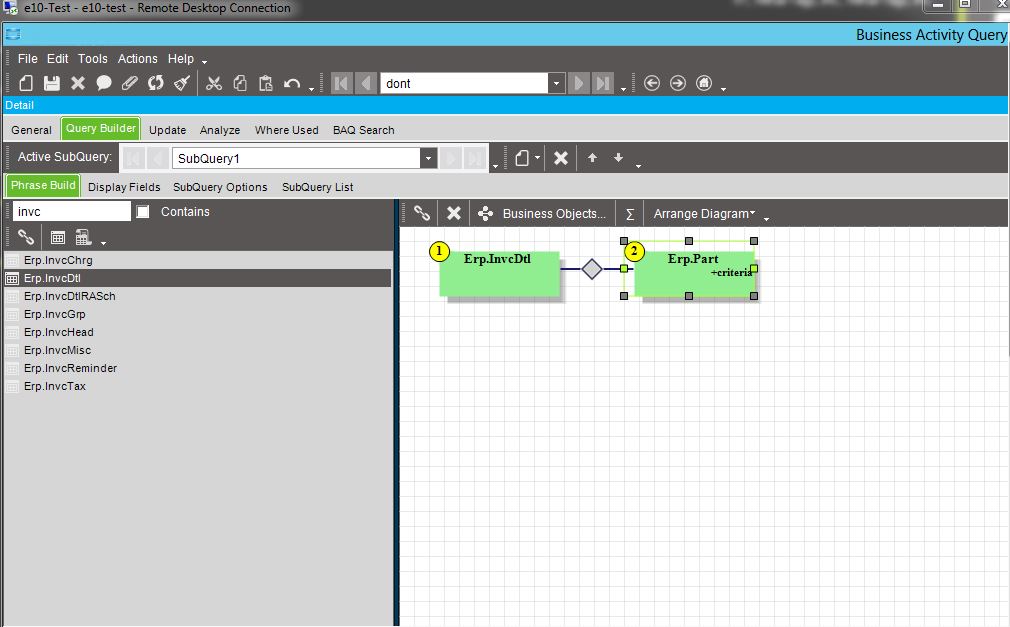

So, first, I created this. This shows correctly the parts customers have purchased.
I have to group these to keep them from multiplying because I am using the Invcdtl table. It also does this with the orderdtl table as well. But it works out. I have 13 categories and most customers never buy all the categories.

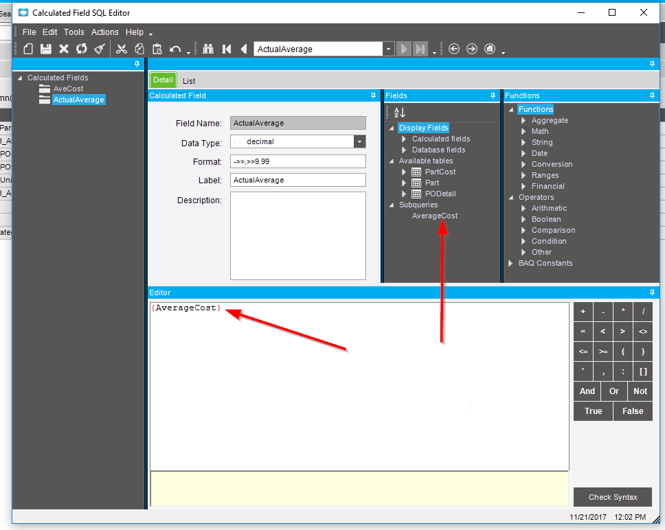

You either need to make a calculated field that brings in the result from the subquery, or you need to bring the subquery into the top level as a table
It looks like this when you bring it in. However, it will only work with one display field showing. More that one will not work this way.
If I bring the subquerry into the top level, will more than one result be ok? I need the custnum and the part.refcat they do not purchase from?
yeah, the calculated field won’t work because you will return more than one row. You’ll have to bring in the subquery to the top level.

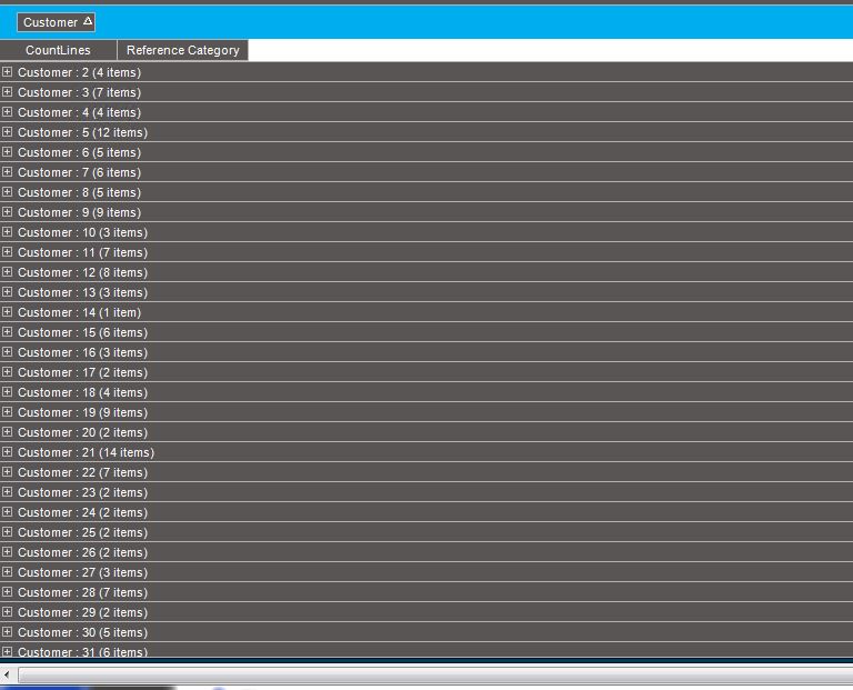

That BAQ is very close to what I am looking for. If I could just get all the Ref Cat to populate that would be perfect. In my system, it shows what they have purchased and only a few are zero’s. But otherwise, case statements is my choice of poison. Getting fairly decent at those. Much appreciated.
What’s missing?
I have 13 reference categories. So every customer should have 13 items in them, with zero’s for the ones they don’t buy, right?
