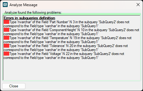

I get an error when attempting to do that:
The column types must match.
So for the first error, you need Part Number from both subqueries to both be nvarchar or both be varchar. What you might want to do is plan on them being nvarchar, and then if you bring a varchar field, use a calculated field of type nvarchar in your Display Columns, instead of adding the varchar field to the Display Columns. The calculated field could probably just say “convert(nvarchar, PNfield)” where “PNfield” is the field in varchar type.
