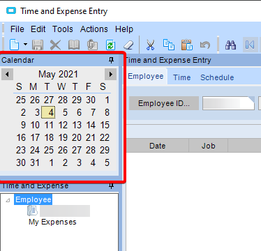

Is it possible to Subscribe a BAQDataView to a field not associated with an EpiDataView? Specifically, I want to Subscribe a BAQDataView to the CalendarInfo.ActiveDay.Date value from the Calendar control in Time and Expense Entry. This value is updated and stored in “oTrans.SelectedDate”.
The following code compiles without errors, however, no data is retrieved due to no ColumnChange method associated with oTrans.SelectedDate.
