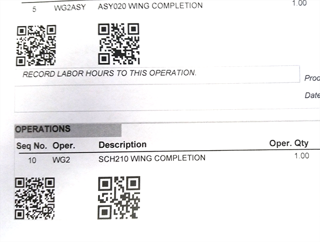

Just letting everyone know here on this particular thread… I was able to write my own DLL that calls an open-source QRCode ā€œencoding DLLā€ which formulates a byte-type memory stream in order to build the QRCode into a PNG object. Once both DLLs are defined in the SSRS report, I simply use a picture object in the SSRS report to call the function I need (similar to how everyone is calling web-based QRCode generators). The picture object is merely the placeholder upon which the memory stream writes, essentially ā€œfillingā€ the placeholder with the QRCode.
qrcode-example
The significance of this for me personally, is that I can write as many values into one QRCode block as I need for any specific scanning requirement that my employer demands. In this particular case, you’ll notice that (if you use a cellphone-based QR scanner on the left-hand codes), I can put the job number behind a ā€œ[JN]ā€ tag and the operations sequence behind a ā€œ[OP]ā€ tag. This helps your ā€œlistenerā€ code on the data-entry side determine what type of data it is looking at and where to parse it.
That’s the part I’m working on now - but I just wanted to share that with everyone, especially those who have thought about QRCode on SSRS reports (just know that your conversations here were instrumental in getting me going in the right direction).
