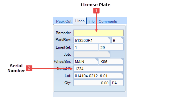

In E10 I think the PCID Feature is meant to be the “License Plate” and as you can scan it, it would Process all other information.
Just beware whatever you do try to stick to Code39, Code128 - it is very unlikely your company has high-end portable/stationary scanners that support those PDF Barcodes etc… =)
In E9 I created my own PCID but that took quite some work. I know where you are coming from.
I’m dying to learn all about PCID and how to implement it in E10… alas there are only so many hours in the week (including my time on the weekends too)
I haven’t used it yet since it wasnt quite ready (In 10.1.400.x atleast only the Setup Screens were ready).

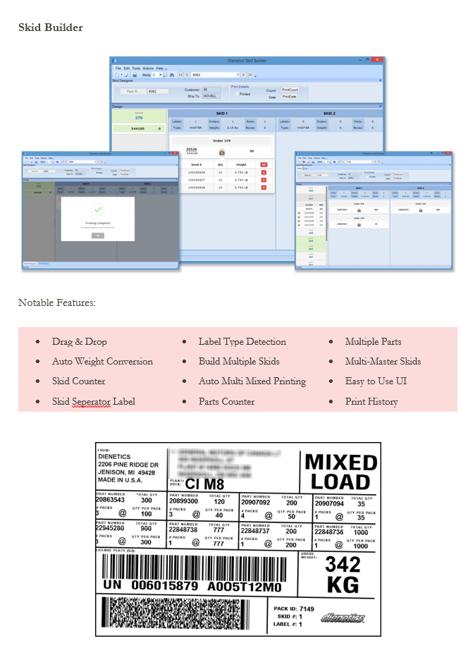

For the time being I have my own PCID Engine which also accurately lets Machine Operators Print Customer Labels taking some weight off the Material Handlers. Handles Mixed/Master/Multi-Master labels and works with BarTender Re-Print Console etc…
Very impressive, sounds like we have similar needs. So where’s that
download link? :joy:
I really would love to hear more about your implementation!
