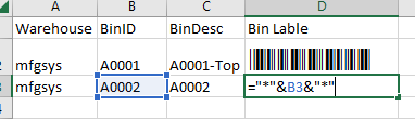

Add the Dataworks39 font (or any other 3 of 9 compatible font) to the computer
Make a formula in excel that adds an asterisk to the beginning and end of the part number
Make that cell font be the barcode font
Like:

I don’t know if printing barcodes onto labels is easy to do in excel. Might need to just create the formula with the font formatting, then copy that row and paste into a word doc or any other format that lets you do the page setup for labels.
