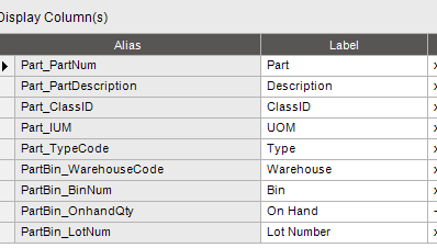

I made a BAQ to get this data.
i did a join on PartBin and Part
then made a simple dashboard so a user can search by Class, Partnum, Warehouse, Bin
Thank you - the BAQ makes perfect sense
