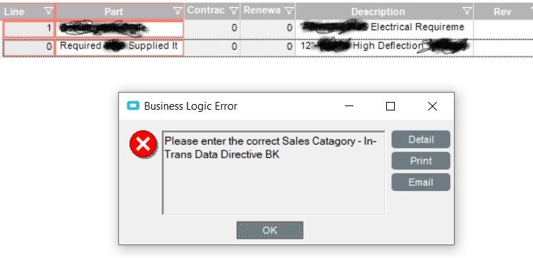

I added an In-Trans DATA Directive for QuoteDtl, but when pasting multiple lines, I still get the attached error after every line. There are 103 columns (the list view of the line items on Quotes) and the required column that gives the error is the 15th column. I would have thought that the check would occur after all of the details on the line are populated, but it seems to check before that happens.
The Sales Category is valid in the excel file, so after I say OK to each of the Business Logic Errors, the lines are in (without pricing). If I paste update (the same exact excel file) then no errors occur and the prices are brought into the list view of lines on the Quotes.

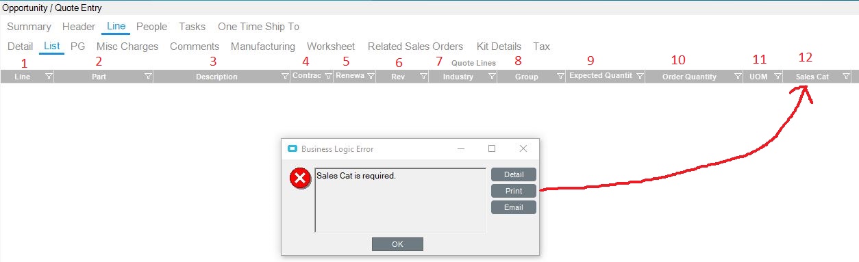

I used the in-trans DATA Directive as recommended by @timshuwy, but still got the errors. Then I moved the columns around on the Line List view as recommended by @Ernie. I did not need the required columns to be left of the Part number, but I needed it to be positioned at the 10th column (or further left) in the line list view. I moved the Part Number and Description columns further left (to see if it was a proximity to the main field), but when I moved any of the required columns to the 11th position or further right (on the line list view) then my exception message pops up.
I then disabled that in-trans data directive and tried using extended properties (adjusting the the column position in the Line List view) and for any required field being in column position 11 or higher (in the line list view) I get the standard Business Logic Error message popping up.
So, whether using Extended Properties or an in-trans Data Directive, any required fields must appear in column 10 (for further left) on the line list view or an exception is thrown when pasting in multi-lines into the line list view.

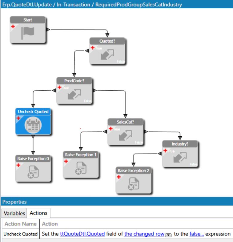

@timshuwy was right stating that I should use an In-Trans DATA directive for QuoteDtl to verify that the required fields are populated. The first condition that I used was ttQuoteDtl.Quoted field of the changed row is equal to true. For this to condition to trip, a user need to check the Quoted box and then Save (or attempt to move to another record, which gives you a popup to save). If you try to save and do not have one of the required fields populated, my exception is raised. What I try to do after that is to Uncheck Quoted (with a Field Setter), but it does not uncheck. If Quoted stays checked, then it keeps raising exceptions and making it more difficult to make the proper selection of the field.

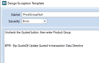

So My solution was to include a message in the “Raise Exception” widget. I instruct the user to uncheck the quoted button and then enter the required information.
