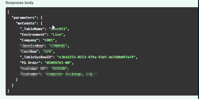

Try this via REST (inside Epicor via BO)
BO is Ice.BO.Attachment
31 is the FileXRef num from the attachment.
[POST] https://SERVER/Instance/api/v2/odata/C001/Ice.BO.AttachmentSvc/DocStarGetMetadata
  "xFileRefNum": 31,
  "metadata": {
You’ll get back the docStar meta data for that file

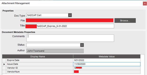

We already track what kind of certs our suppliers should have via attributes. So I already have a list of who should, for example, have NADCAP certs on file. We don’t track too many key certs (like 4 right now), and I don’t want users typing in cert type when uploading, so I’ve just created separate DocTypes for each then tied them to the Vendor table.

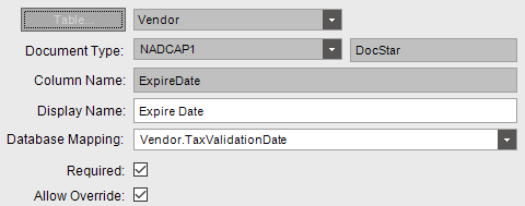

Next step was setting up the metadata. The system requires me to tie ERP-side metadata to a field. It also didn’t let me select a custom field. So I grabbed a tax date field that we’re never going to use and checked required and override.
Now, when they attach a cert, they’re prompted for issue and expire dates. Cool. Exactly what I’m looking to do.

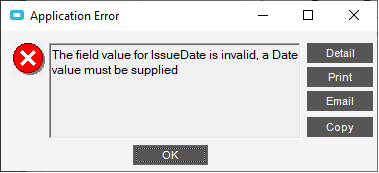

If they forget, the system gets angry. Great.

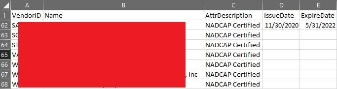

Final step in the demo required me to parse the XFileRef.XFileName field, grab the corresponding ECM record (via Document, DocumentVersion,CustomFieldValue and CustomFieldMeta), and present the SME’s with a concept for a potential widget/dashboard that will let them keep on top of potential upcoming cert expirations.
FYI:
LEFT(XFileRef.XFileName,CHARINDEX(';',XFileRef.XFileName,0) -1) = Document.Id
It’s not much, and not what I originally asked (I’ll get there), but haven’t seen much in the way of implementation/integration stories on here so I thought I’d share my first tentative steps.
