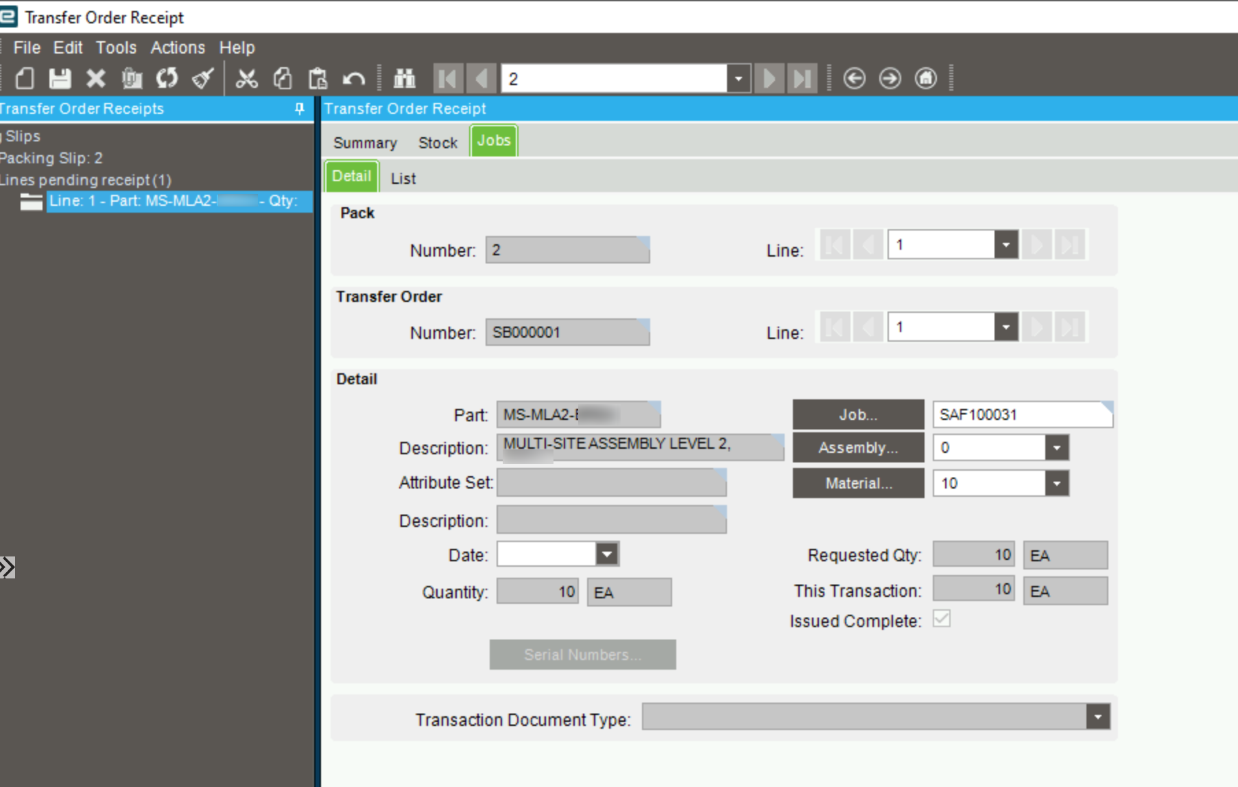

@timshuwy - the project I’m currently on is multi-site, and all make parts are non-stock, they do not have a concept of inventory, period - so I want to try the non-stock, make to job transfer orders between sites - and I know I was able to do this several years ago with some jiggering, but can’t remember the sequence. I have the parts set up correct, with transfer definitions and so on, and it creates all the jobs correctly with make to job demand links, and creates the TO suggestions correctly, but when I go to do the TO shipment, it’s stops me with a “the transaction will result in a negative on-hand qty”, something I did not expect with make to job. Any clue about the steps?
p.s. so I did try bypassing the TO Shipment Entry, and went straight to Job Receipt to Job, and it took, but it also closed the Transfer Order, so I couldn’t complete the TO Shipment - and that was one of the customer’s requirements, to have a shipment transaction.
p.p.s. tried doing the transfer order receipt at the receiving site but when I go to Actions / Receive it doesn’t actually do anything, the line just hangs out in the ‘pending receipt’ section
