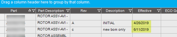

I have a BAQ im trying to create that pulls all of the operations associated with that part; im creating a bill of operations for one of my engineers. Problem is, we dont need to see the duplicates created by the multiple revisions that exists on some parts. Easiest way for me to do this was to trust my coworkers only Approved one revision and sort by that. BUT when i set the criteria for Approved = TRUE, im still getting unapproved revisions in my list. I checked the part master and the rev is 100% unapproved and yet its still showing as approved when i pull it in.
Am i using the wrong fields to pull the rev?

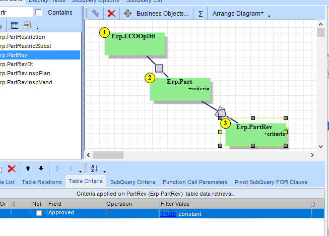

What are the Table Relations between Part and PartRev?
edit
Never mind. I see in your query expression.
Make that relations ship be an inner join

I tried this but it doesn’t do a group by the PartNum to bring in the latest (max) effective date correctly. How would we do a group by PartNum and bring in the max effective date?
Yeah, that version still listed all revisions - approved, effective.
You can try this one instead
Same basic query except if you look at the joins, you should notice fewer key fields specified.
This way it can pick a single rev per part.
CUS-LatestPartRev.baq (37.7 KB)
