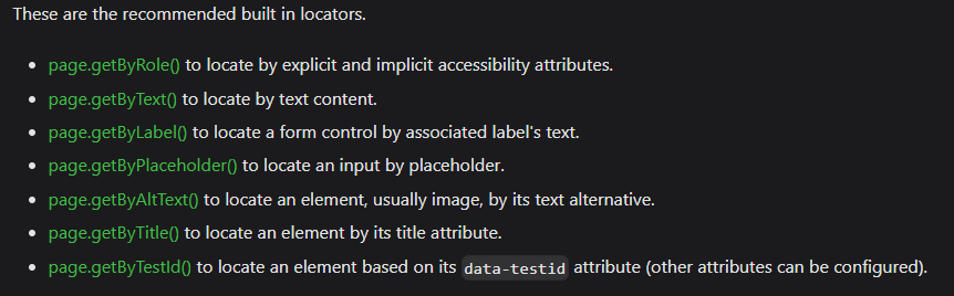

I updated the Epicor idea so @bconner knows. There may be another Locator we could use?
Page.GetByText for example. ![]()
These are the kinds of things we’ll need to flush out. This is a common problem with all web testing frameworks.

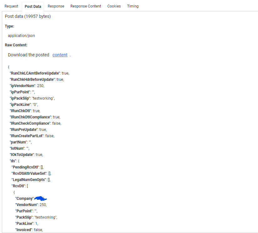

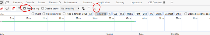

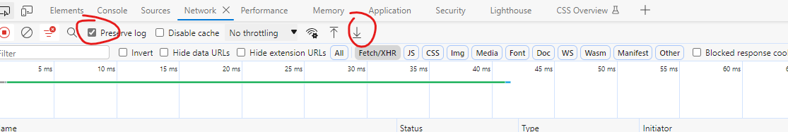

I found success with this:
To export data views/business object param datasets from Microsoft Edge DevTools, follow these steps:

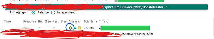

F12 or Ctrl + Shift + I.Then use HAR Analyzer (googleapps.com) to open the file you saved. Find the business object method that you want the payload for and click the gear/settings icon circled in blue in the photo below. Then go to the post data tab (seen in the second photo below). I wish it wasn’t an online tool and sharing the logs with google… maybe someone has an offline option we can use?

The first thing that we need to know about web dev is that every web page is represented by the Document Object Model. Think of it as a tree structure where each node contains optional attributes and children elements. The DOM is able to find elements on the page for styling or actions. Playwright abstracts these methods into Locators.
In strict HTML, one and only one element should have a unique ID. When Playwright says, “Locator(”#EpCheckBox1023"), it should be able to find that element quickly. Now, if the ID is constantly changing, we see that as a problem since we can’t rely on it. If you went to your recorded code and change the Locator:
await page.Locator("#Checkbox1023").ClickAsync();
to
await page.getByRole('checkbox', { name: 'Received' }).check();
which finds the checkbox with the label “Received”. We could also use just the text, but if it appears more than one time, that would have to be handled to make sure you have the correct element.
