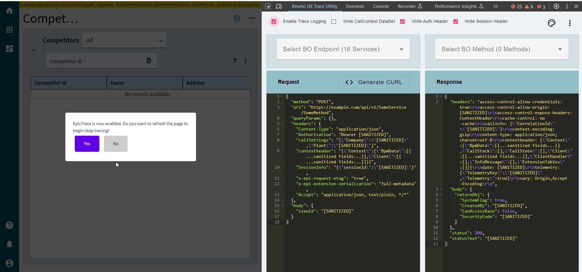

Kinetic Trace Helper Utility 1.0 (Kinetic Web) Chrome Extension
After seeing various discussions around tracing for Kinetic
And seeing how popular the Trace Utility Parser was
@jgiese.wci and I decided to start experimenting with a Chrome extension that would bring back / help with some of that functionality in the Kinetic Universe.
V1 Launch 10/31/2023
Here’s a Walk Through of the Functionality in Relase V 1.0

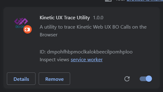

We have submitted to Chrome for Web Store approval but that may take a few weeks. In the meantime you can side load here’s the install zip we will update this with a link to chrome store once appoved.
Color me gobsmacked the extension has been approved and published to the Chrome Web Store :tada::tada::tada:
Follow regular extension install instructions then, you should then see it in your installed Extensions:
V1 Features
  • Enable / Disable Capture on demand per site
  • Capture all outgoing and incoming JSON requests from Kinetic Client to Server
  • Group Requests by Business Object and Method
  • Generate CURL Equivalent of a Given Request
  • Import to CURL Command to Postman
  • Save Trace Dump
  • Load Trace Dump

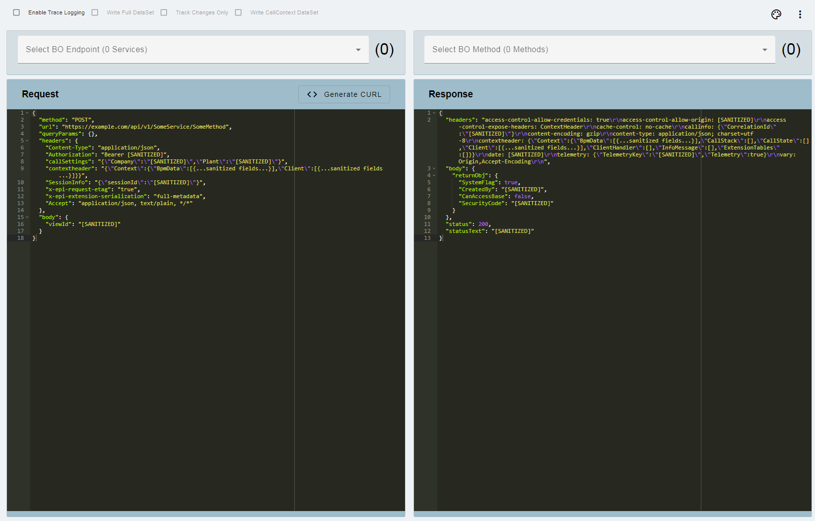

@jgiese.wci Skinned it alive and we added some new features so I present
V 0.5
  • New UX Experience
  • Enable / Disable
  • Save to File
  • Load from File
  • Hide / Show Headers
  • Generate CURL Command (thanks for the neat request @spaceage )
Demo
Download:
KineticUITrace.zip (407.8 KB) V0.5

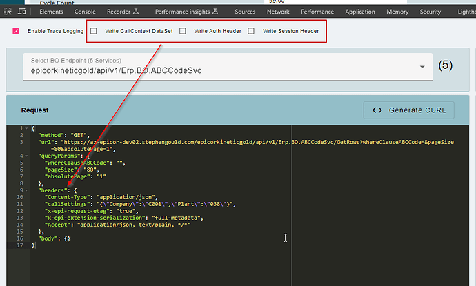

Strip out authentication headers? That would be nice.
It’s already there :slight_smile: that’s part of the new feartures we added you can strip out
CallContext, Auth, and Session headers (if you chose to)
But… if you leave them in, you have a 1 click import into Postman that works and uses your TOKEN…
