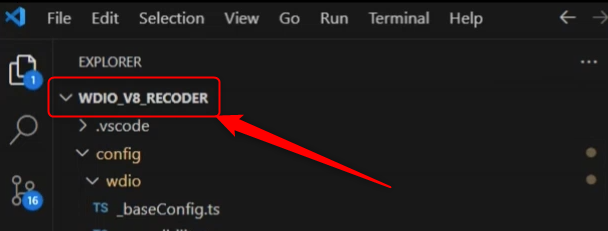

Based on the example within the recording, it looks the core framework might be WebdriverIO v8, which I am hoping to be the case.
We have been using WebdriverIO for a while and the biggest challenge was getting started. With some Epicor specific extensions and OOTB configurations, it should be a great solution! Hopefully we can all get access and further details soon! :crossed_fingers:

This seems like an awesome tool! I’m fairly new to this, is there any documentation for once you have the ts files from Recoder on how to actually run them?
There’s an intro video on Learning Center but haven’t seen a tutorial. Looks like a 3rd party VSCode extension. Can probably deduce which one from the vid and find some online help.
Possibly above mentioned WebdriverIO
