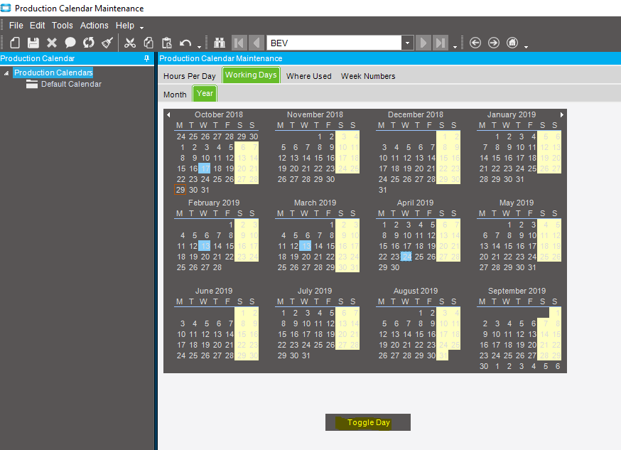

Epicor support’s response is thus:
Go to Production Calendar entry, located in Job Management > Setup. Select a calendar, select the Working Days > Month screen. Here, click a Holiday, then click the Toggle Day button at the bottom to make it a Non Work day.
