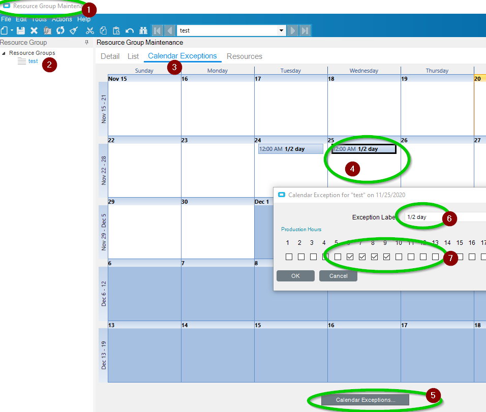

Ummm… but you CAN set Calendar Exceptions for your individual resource Groups or Resources that differ from the standard calendar.
- go into resource group maintenance
- load your resource Group
- go to the Calendar Exception page
- Click on any day in the calendar
- click on the Calendar Exceptions button
- enter a label
- click on the number of hours you want to work that day and press OK.
Once you do this, you will see the exception listed on the calendar, and the system should use this when scheduling.
Individual resource have this same option as well… go to the resources tab and you will see it has a calendar too with a calendar exceptions button.
Thanks! I was hoping for something easier on the main Production Calendar as it is for the entire shop, but that will definitely work.
