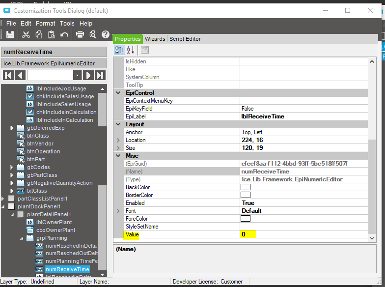

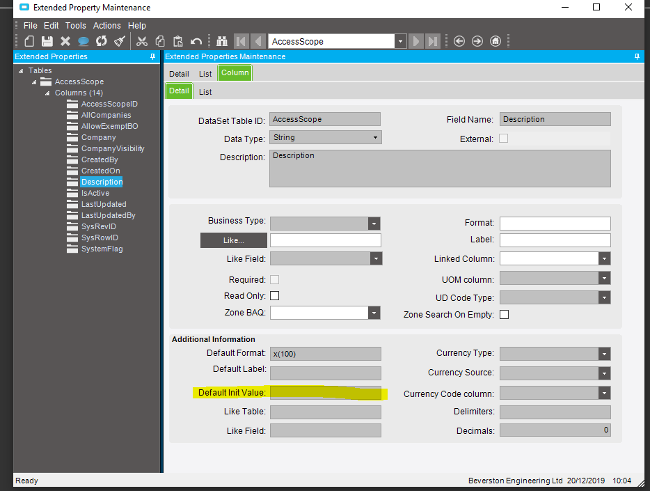

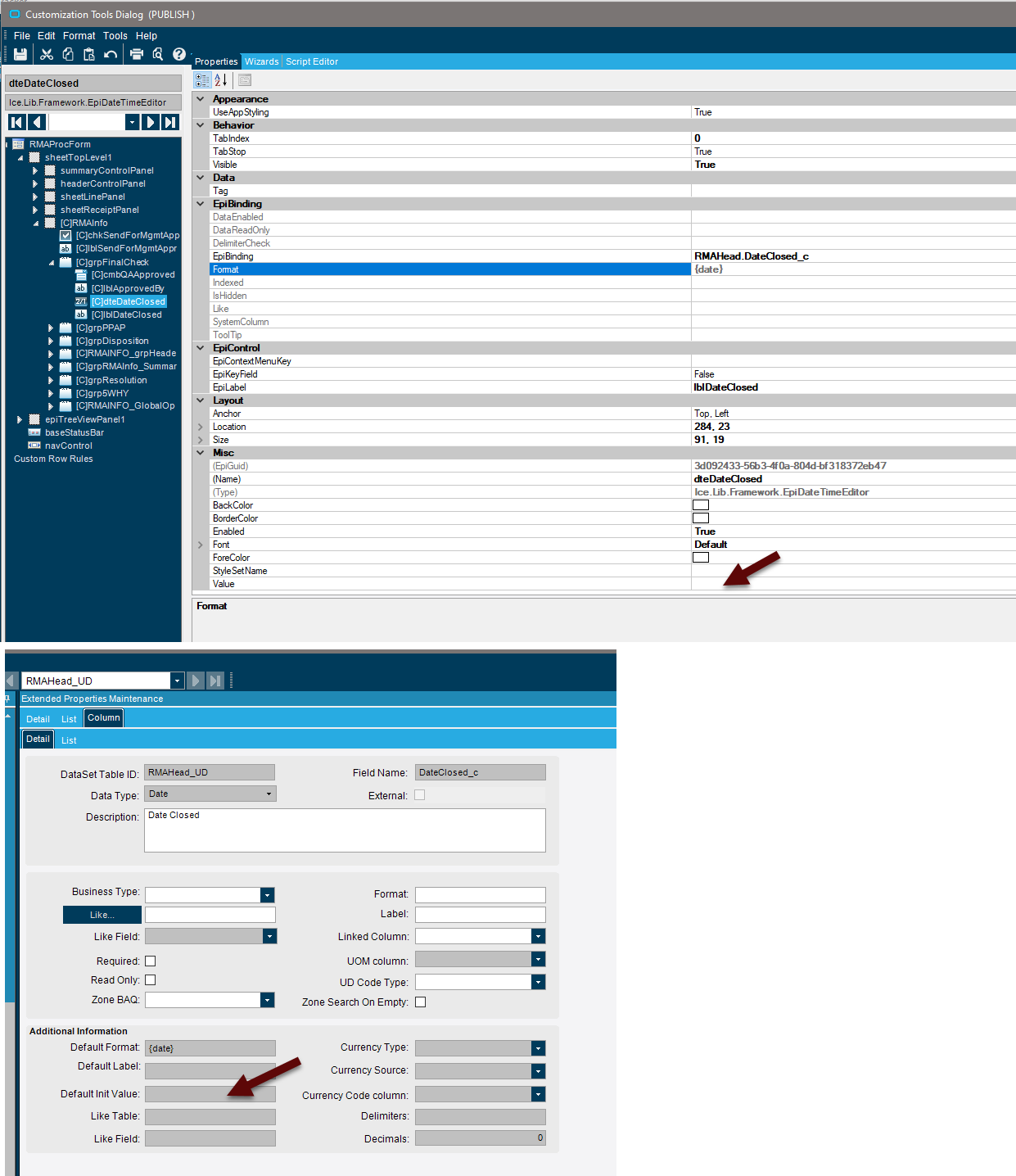

check the initial default value for these UDFs, also open the form in developer mode/ customization and check the edvValue within the properties of this field
Thank you for your reply. I didn’t know about Extended Property Maint before. However both of those spots you highlighted are blank for us.

It’s like the screen won’t let you save with a blank date, it doesn’t recognize blank as a valid value.
I put a request into Epicor support about this and this is now (thanks to me) a known problem on RMA screen with date fields.
This doesn’t happen on all screens, so far only the RMA & DMR screens displays this behavior. Epicor Support put a problem case in. PRB0218852
