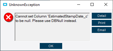

A “blank” date should be the value null. Try doing:
edvUD100.dataView.Table.Rows[0]["EstimatedStampDate_c"] = null;
You can’t null a date field I don’t believe…
Could of just used, DBNull.Value.
Sorry for this pointless post…
I think that’s the most helpful error message I’ve ever seen…
I thought that was as well… Normally they’re like riddles… :smiley:
