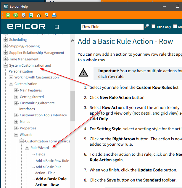

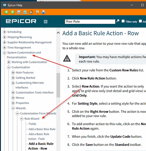

A RowRule can help here, Condtion => Recieved = true Action: Disable Received.
You are a genious.
But how do I do that?
Customization Guide is available in EpicWeb (or the Epicor Help Menu) covers RowRules pretty thoroughly. I’d start there, come back if you run into issues and we’ll gladly assist.
