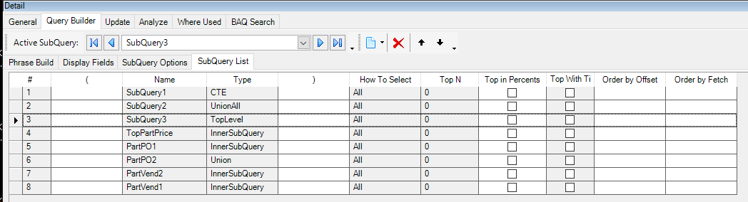

We have a BOM BAQ that uses CTE and builds the BOM properly. I now have to add the last cost I have for the part. In a separate BAQ I have a union between data pulling from POs and the vendor part history. Both queries independently work fine. I am having trouble putting the 2 together to get the cost per part line in the BOM.
The original BOM has a join to the Part table to pull data for each part and that works fine. When I try to join in the subquery for the cost I get all of the data from the cost query, not just the matching part data even though they are joined by the part. I think it may be caused by the union in the cost subquery but I don’t know how to structure the queries to achieve the desired results.
I’m not sure what to include in this to provide more information. Here is a snapshot of the query list

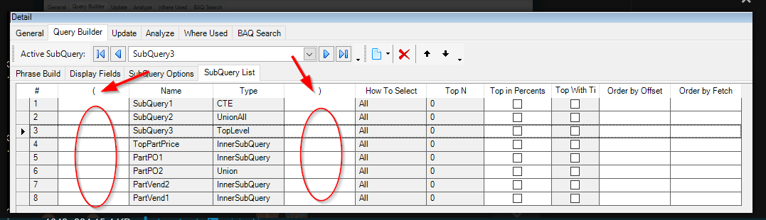

Use the () to group the appropriate things together. A union is going to grab everything below it, unless you use the parenthesis.
That helped me get on the right path. I forget about those since I don’t use them often. Thanks!
