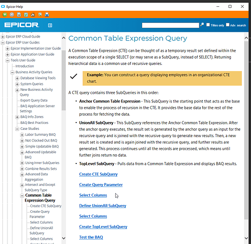

Look in the tools guide, there is a step example of exactly what you are trying to do. Basically a CTE lets you reference the same query and recursively loop through your data, then it adds all of the rows into a union.

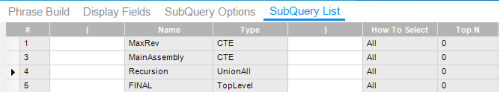

Here is an example. RecursionExample.baq (55.4 KB)
SubQuery Description
MaxRev I use this as a filter on the Recursion subquery. It returns the max approved rev
MainAssembly This is the Top or Level 0 part of the BOM.
Recursion* This returns all parts associated down the BOM for the current part level
FINAL This is where I place the MainAssembly CTE.
*Note: On the Recursion, I have put a SubQuery Criteria of the Calculated Level Field <= 5. This limits the BOM to 5 levels down.

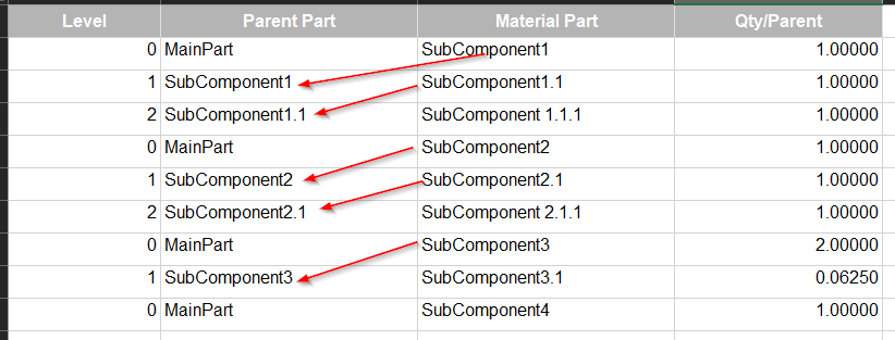

The output is like the following:
Which can be looked at like:
  • MainPart
    • SubComponent1
      • SubComponent1.1
        • Subcomponent1.1.1
    • SubComponent2
      • SubComponent2.1
        • Subcomponent2.1.1
    • SubComponent3
      • SubComponent3.1
    • SubComponent4
