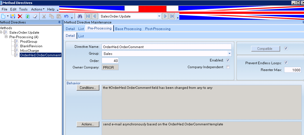

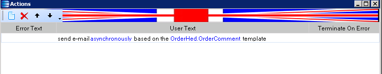

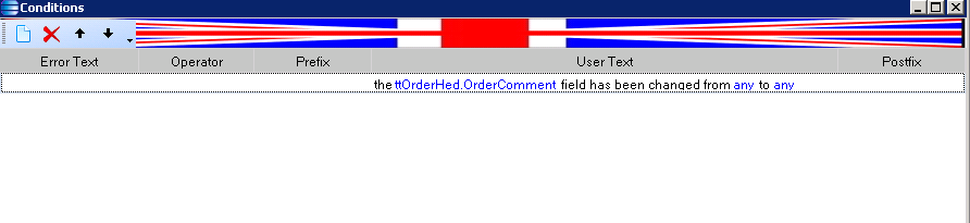

You shouldn’t need any code for this, write a BPM on Pre-Processing Update condition OrderHed.OrderComment changed from any to any
Action -> Send Email

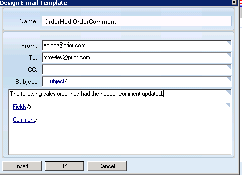

I think i must be doing something slightly wrong as the email is not being received:

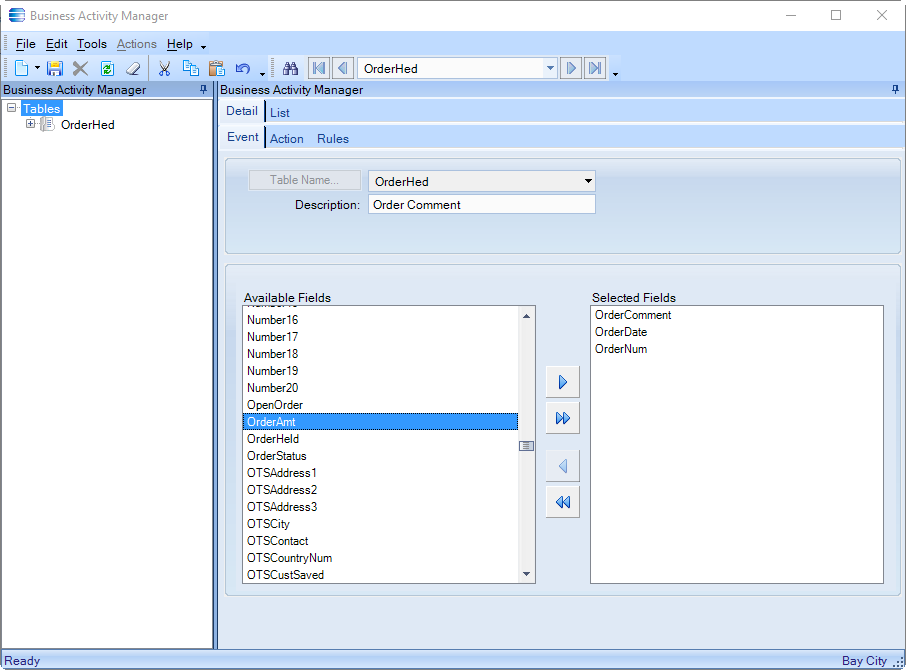

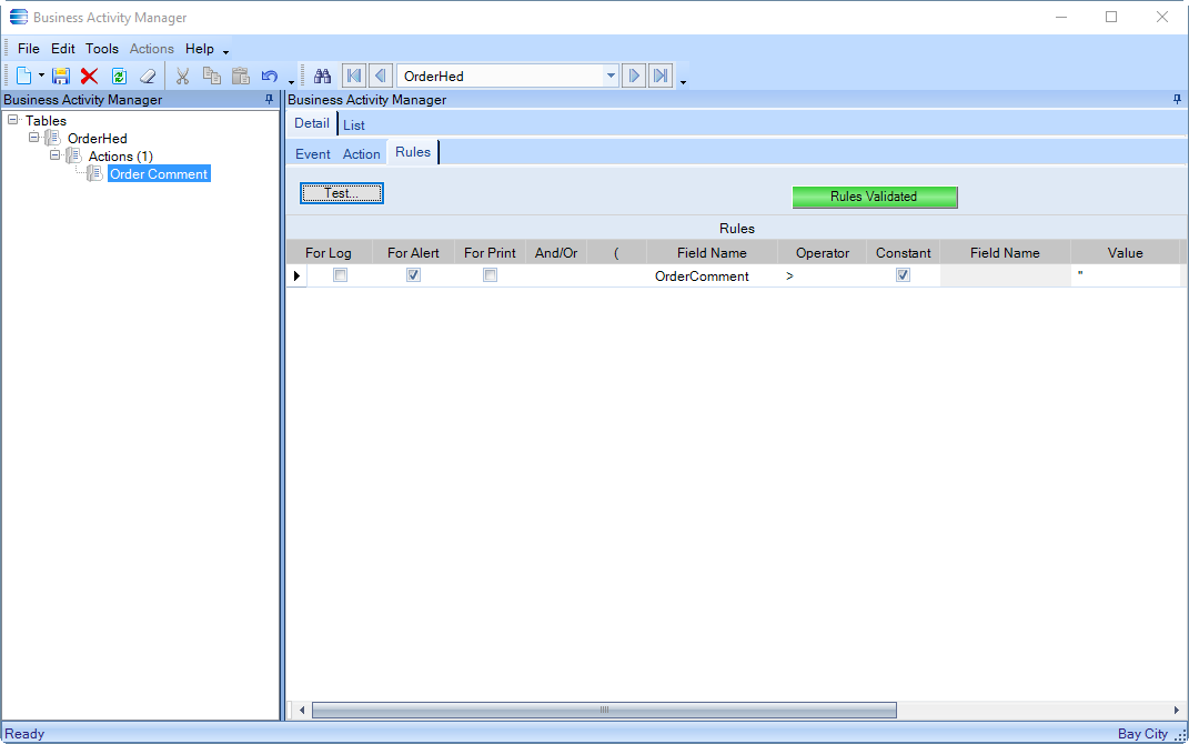

Create a new BAM for the OrderHed table and add any fields that you want
displayed in the email.

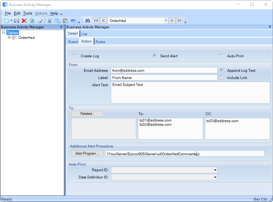

Set Action to send email to recipients using Alert Program. (See
below) You will need to create the Alert
Program before completing this step.
Set Rule to OrderComment > ‘’ and Test to validate.

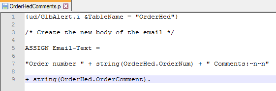

Using a text editor, create the Alert Program, OrderHedComments.p, and save
in
\YourServer\Epicor905\Server\ud\ folder…

it seemed to be the email address i was sending it to
its now working.

While Jose is correct you can do this in a bpm, I like using a BAM so I can make a nicer looking and versatile email.
Attached is one I made from an OrderRel bam I had. It has not been tested.
You have the OLD data available, so you can show the original comment and the new like I do with credit limits below.
IF Customer.CreditLimit <> OldCustomer.CreditLimit Then Do:
vBody = vBody + “~n~n~tOld Credit Limit:” + string(OldCustomer.CreditLimit,"$>>>,>>>,>>9") +
“~n~n~tNew Credit Limit:” + string(Customer.CreditLimit,"$>>>,>>>,>>9").
End.
Else do:
vBody = vBody + “~n~n~tCredit Limit:” + string(Customer.CreditLimit,"$>>>,>>>,>>9").
End.
If you want to do this then make a bam on the comment field being changed and first make send the generic email. The instructions attached are from the Vantage site on how to make a bam.
