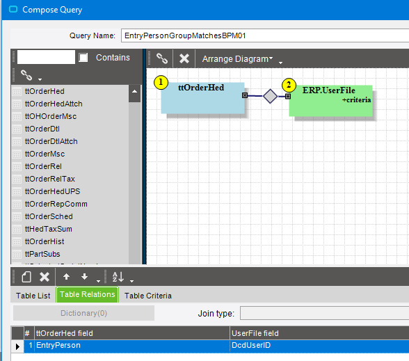

I’m attempting to have a BPM condition looks to see if the OrderHed.EntryPerson is a member of a certain security group, but no matter what, the condition always returns FALSE.
I added a condition with a “Number of rows in the BAQ query is not less than 1”. In the BAQ, I joined 1. ttOrderHed to ERP.UserFile using EntryPerson to DcdUserID, and added a criteria to the UserFile of GroupList MATCHES “%BPM.01%” constant.
This works fine when I test it on a normal (non-BPM) BAQ - I get one line for OrderHed joined to UserFile with the same criteria.

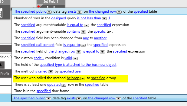

Does the following condition type not meet your requirements?
Or is the OrderHed.EntryPerson not the one initiating the method call?

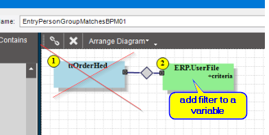

For added efficiency you should never JOIN a tt table to a database table (search E10Help for discussions on this topic). Instead, your BPM should create a new variable called UserWhoEdited, and then use a setter widget to set this variable from ttOrderhed… THEN in your query add a filter to find where the user ID = UserWhoEdited. I have seen conditions where this simple change can increase the speed of your BPM by several hundred milliseconds.

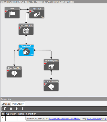

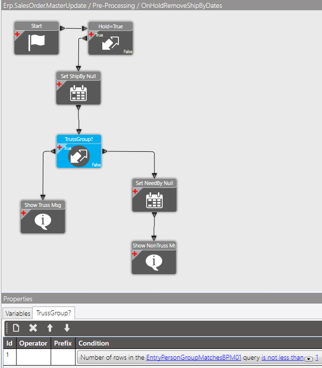

@ckrusen, Not always. Originally I had “user who called the method belongs to specified group”, but then our credit department reminded me that they are adding/lifting credit holds on all orders, so I needed a condition based on what group created the order initially. OrderHed.EntryPerson seemed static enough to use for that…
@timshuwy, thanks for the reminder! I’ll give that a try. I think there’s an extended ed example I can follow along with in my notes.

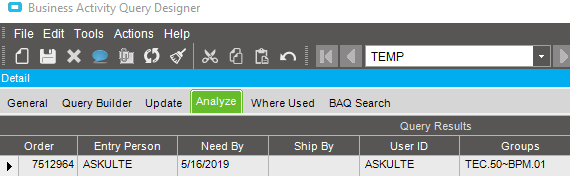

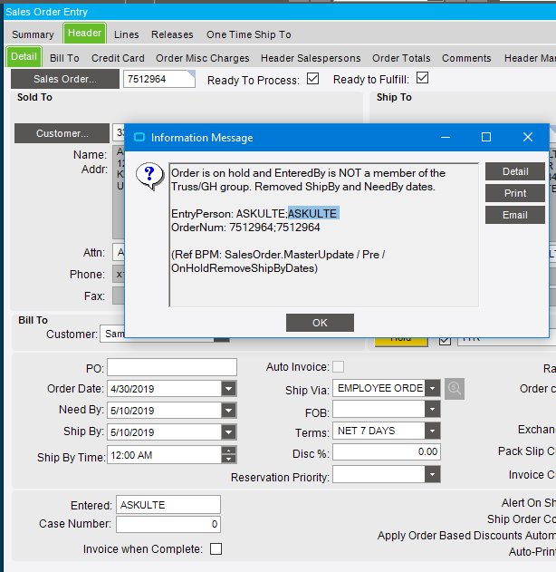

Calvin - That worked! Why? Is ‘Matches’ wildcarded already? I figured I needed to use the % wildcards since the UserFile.GroupList format is Group1~Group2~Group3 and so on… From the BAQ test:
What’s weird is that removing the before and after % wildcards % in the BAQ (not the BPM BAQ), I get no results. Kind of frustrating when a BAQ acts differently in BAQ Designer or BPM Designer. Why is that too?
