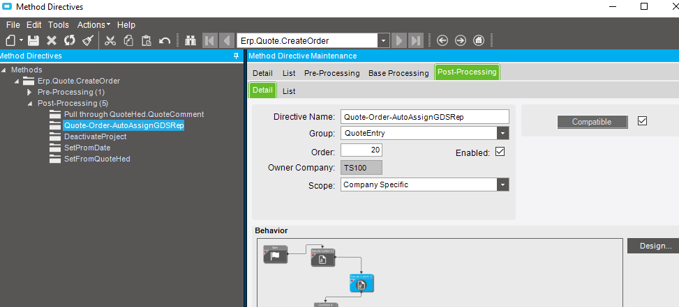

Bpm Converting Quote to SO not mapping correctly
When converting quote to SO with multiple line items the rep groups are not mapping correctly from the quote on subsequent lines. Line 1/release 1 maps as expected but subsequent lines only mapped the ship to rep group (QuoteHed.Character10).

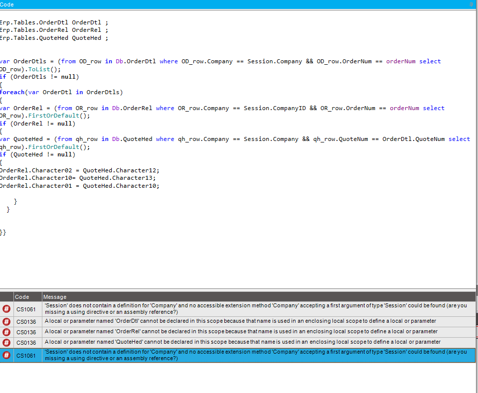

I’m getting some errors

Ok, I see the error,
Remove this part of the code
And where I referred to Session.Company it should have been Session.CompanyID
Updated code below
var OrderDtls = (from OD_row in Db.OrderDtl where OD_row.Company == Session.CompanyID && OD_row.OrderNum == orderNum select OD_row).ToList();
