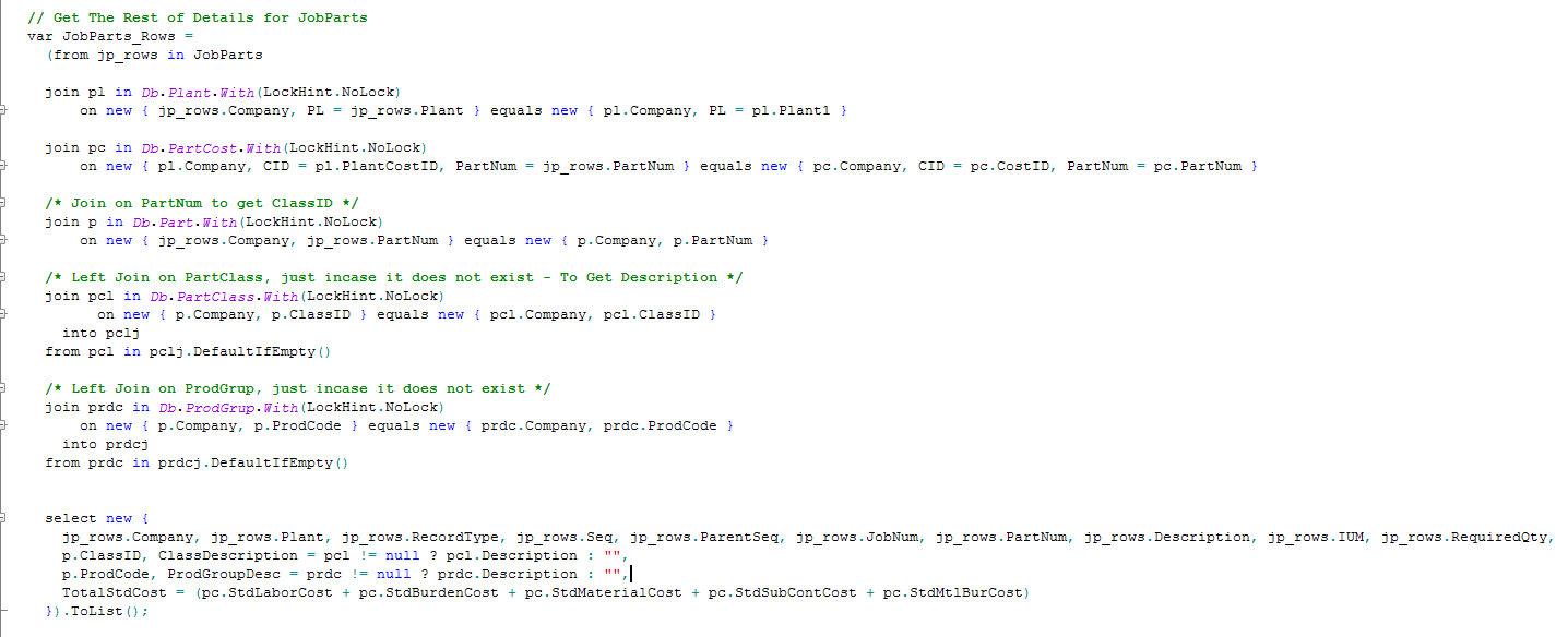

Epicor does support Left Joins.
Are you able to get the join to work with out all of the extra stuff Just a plain left join? Then add to the where clause. Reduce the number of moving parts in the code.
