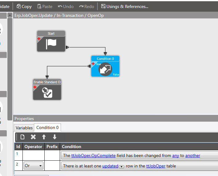

OpenOpList.bpm (33.2 KB)

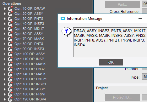

For my jobs it seems to get the correct ordering, but they are fairly simple. I took your routine and made as few changes as possible (rowmod was changed, so it did not run twice) and one I made closer to how I would write it and both produced the same list.
Can you add the write lines or use the below to see if your data somehow does not get ordered.
Since this is on a DD and is going to get hit a lot, I would bring all of the JobOpers records and only the fields needed from the Db once and then iterate that to make the list.
I added the comment at the top because I can’t stand seeing code in the action pane.
The start and end show when the routine begins and ends. The list shows me in the severlog what is happening in the code.

I changed it to a method and modified when it updates. Still doesn’t sort correclty.
