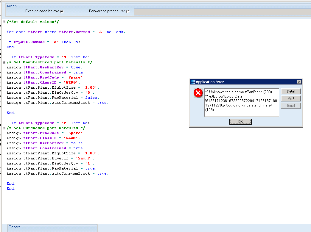

Hi Greg, how does this look for a first draft!?
/Set default values/
For each ttPart where ttPart.Rowmod = ‘A’ no-lock.
If ttpart.RowMod = 'A' Then Do:
End.
	If ttPart.TypeCode = 'M' Then Do:
/* Set Manufactured part Defaults */
Assign ttPart.UsePartRev = true.
Assign ttPart.Constrained = true.
Assign ttPart.ProdCode = ‘Spare’.
Assign ttPart.ClassID = “WIPG”.
Assign ttPartPlant.MfgLotSize = ‘1.00’.
Assign ttPartPlant.MinOrderQty = ‘0’.
Assign ttPartPlant.RawMaterial = false.
Assign ttPartPlant.AutoConsumeStock = true.
End.
	If ttPart.TypeCode = 'P' Then Do:
/* Set Purchased part Defaults */
Assign ttPart.ClassID = “RAWM”.
Assign ttPart.UsePartRev = false.
Assign ttPartPlant.BuyerID = ‘Sam F’.
Assign ttPartPlant.MinOrderQty = ‘1’.
Assign ttPartPlant.RawMaterial = true.
End.
End.
On the Add the typecode will be M or P and the PartPlant record won’t exist yet. I have the same Part defaults on Part.Update with a condition of the TypeCode changed from M to P and vis versa. For PartPlant I use a data directive. The one below should be close. The fields limits the data returned to speed the read up.
The if rowmod then end at the top doesn’t do anything so it can be removed. The top section is one assign with a period at the end. That is the fastest rather than multiple assigns. I don’t think with four values it would matter, but wanted to show you what I meant.
You are updating so you don’t want no-lock, but I think the assign will override that anyway.
I don’t think the numerics need quotes and again I would assign the buyer at the partclass rather than the part.

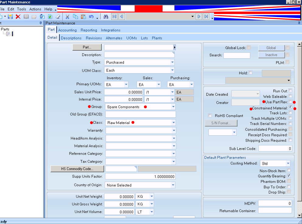

Thanks Greg,
Here is where i’m at…
So, in method directives, i’m doing a Post-Processing bpm on Part.GetNewPart, using the below ABL…
If ttPart.TypeCode = ‘M’ Then Do:
ttPart.ProdCode = “Spare”.
ttPart.ProdCodeDescription = “Spare Components”.
ttPart.ClassDescription = “Work In Progress”.
End.
If ttPart.TypeCode = ‘P’ Then Do:
Assign ttPart.ProdCode = “Spare”.
Assign ttPart.ProdCodeDescription = “Spare Components”.
Assign ttPart.ClassDescription = “Raw Material”.
End.
End.
The results for purchased parts seem to work…(it defaults to purchased when new part is created)…so am i correct i now put the same ABL code into a method bpm called PART.UPDATE and when i flip from typecode P to M it changes the tickboxes etc?
So, the ABL seems to work under PART.GETNEWPART and defaults the specific fields for purchased parts.
I’m getting stuck on defaulting the fields when the part.type is swapped to M

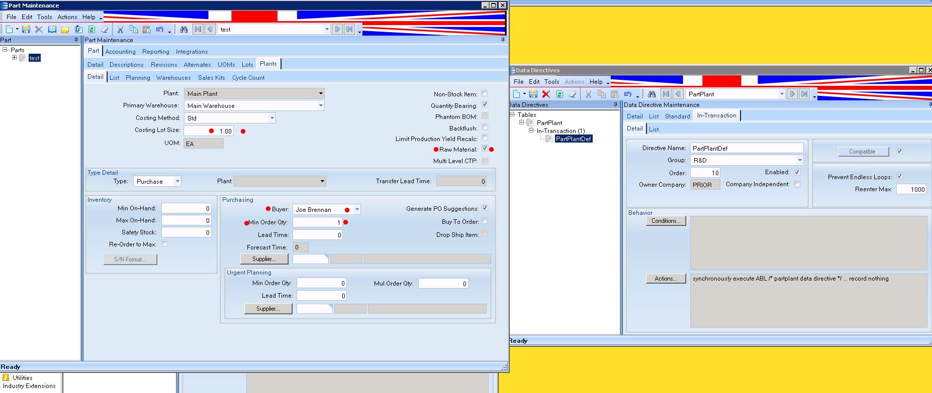

/* partplant data directive */
For each ttPartplant where ttpartPlant.RowMod = ‘A’.
For each Part fields ( TypeCode ) no-lock where ttPartPlant.PartNum = Part.PartNum and ttPartPlant.Company = Part.Company.
If Part.TypeCode = 'M' Then Do:
Assign ttPartPlant.MfgLotSize = 1.00.
Assign ttPartPlant.MinOrderQty = 0.
End.
If Part.TypeCode = 'P' Then Do:
Assign ttPartPlant.BuyerID = “Joe B”.
Assign ttPartPlant.MinOrderQty = 1.
End.
End.
End.
