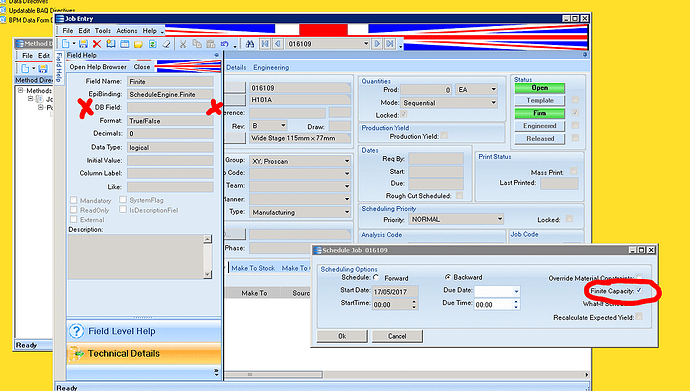

Have you got any clues on the below link?
Many thanks in advance.

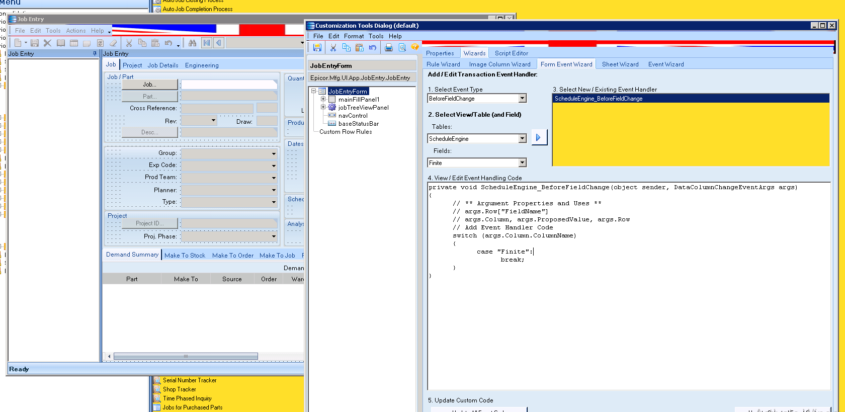

I did run a quick trace yesterday, but did not find the method that is firing. I think the quickest way to do this would be a customization and use the data wizard to set the field to true on load of the form.
I do not do very many customizations, but this should be like one in the ice manuals. I will try to run a test later today.
Greg
Hi Greg, i watched the above video…and then started to build it in here:
(but i don’t know how to write now default the field to 1 or True)
