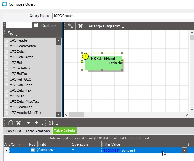

Hmmm… I must be doing something wrong. I’ve gone through some tests and established that I can’t make a query that accesses the other company
This is about as simple a query as you can make it just to see whether it can get to the other company - it can’t

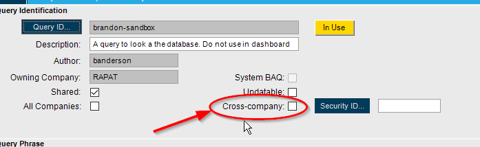

Did you check this box? (We are only one company so I’m not sure that’s the solution)
Yes, the BAQ is cross company and works a treat when it is run from the BAQ form but I want to run it from within a BPM:

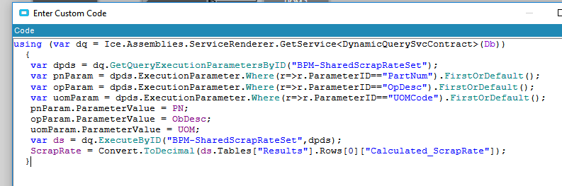

But, here is how I call a BAQ from a BPM on a C# code block. This one has parameters in it, so you should be able to see how to do that for yours.

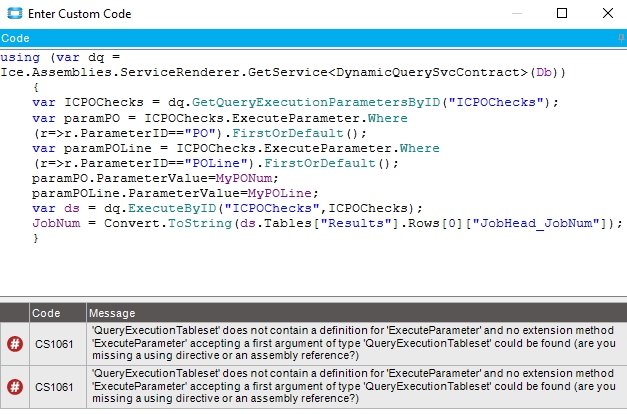

OK I tried that but I’m getting a syntax error:
2019-05-21%2010_05_23-Enter%20Custom%20Code
MyPONum and MyPOLine are integer variables in the BPM and JobNum is a string variable in the BPM
It’s ExecutionParameter, not ExecuteParameter
Also, in BPm you can use Ctrl+space to get some auto-complete going for you. That will help with this type of coding.
Thanks - I just saw my typo as well…
Hey - It works :smiley:
Thanks so much for the code Brandon - Still don’t full understand it but it is getting what I need!

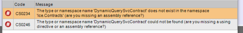

I am trying to follow your code and the other posts on here to use a BAQ within a BPM. Do you have anything in the “Usings & References” area?
I keep getting this error:

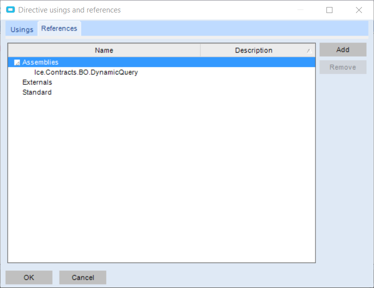

Found out. For anyone else looking for this, it’s in the screenshot below. I kept not being patient enough for the full list to load after clicking add.
Yeah it loads those assemblies super slow. It’s always fun waiting for the list to populate!
