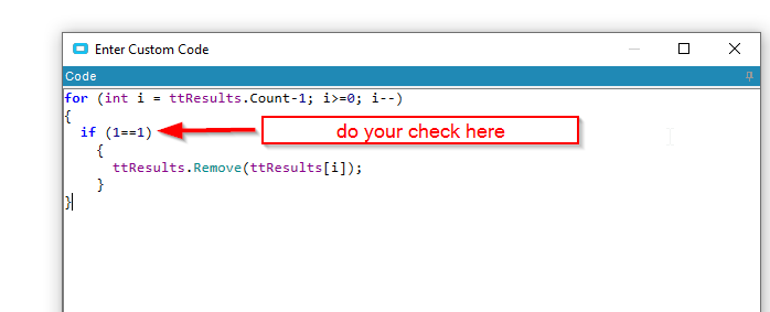

So you have to loop through your results, and remove rows (backwards, because your list if going to be getting shorter). This is how you remove rows. Do your check in the if statement.
edit
have to might be too strong of wording. This is one way to do it.
