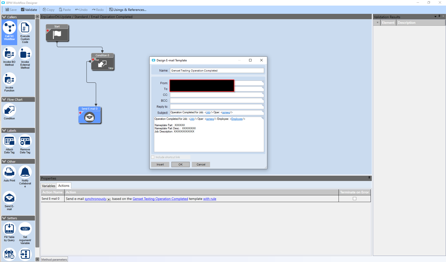

BPM Email upon Job Operation complete & include a few JobMtl rows
I have a working Data Directive BPM that will email upon an Operation being completed. I am unable to grab all the information necessary for the email i’m constructing.
I’ve been able to do this on another project where I was copying fields.
Here is the functional Send Email BPM. I know I need to get to the JobMtl table but i’m not sure how to query that so it shows up in the Send Email function.

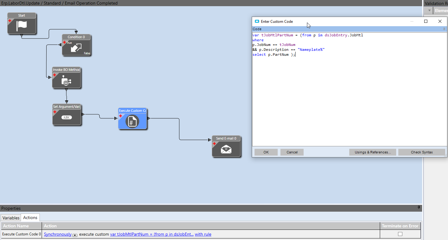

Possibly execute some custom code? Or can I Invoke BO Method for JobMtl.Search
Try creating some variables and then using the Set Argument/Variable widget to populate each variable with some LINQ. Then when you create your email content your variables will be available to insert into the text.

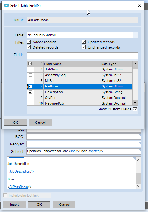

Since I avoided the C# lookup, here is how I accomplished this. Unfortunately, this dumps the entire job BOM into the email with “,” delimiter. Not the greatest solution, i’m really only searching for parts that meet specific criteria.
This did not populate my variable. tJobMtlPartNum
So I just dumped both fields into the email.
