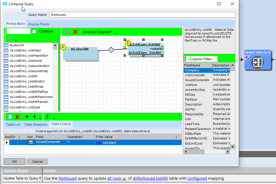

Data Directive - Get from JobMtl where IssueComplete = false
I’m trying to setup a BPM where it sends an email when Operation 80 is completed. Inside the email I would like to list the parts that are not issued. There is a field in JobMtl called IssueComplete but I’m not sure how to map it to a temporary table so I can pull it into the email.
I’m using a Standard Data Directive from the Erp.LaborDtl.Update.
I should be able to link the JobNum and then query the JobMtl.
I created Invoke BO Method for getting the Customer Name and Job Number based on the LaborDtl.Jobnum and that worked fine. I dont see a way to link to the JobMtl and store it.
I dont want to specify an assemblySeq or mtlSeq but this BO is the only thing that might work.
Trying “Update Table by Query” with a new dataset variable.
but I do not get any results.

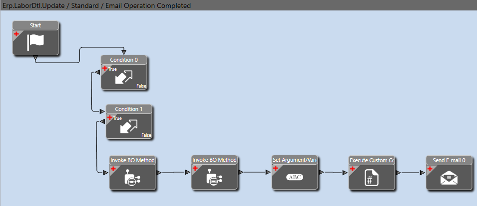

Thank you i’ll post my detailed results after im finished!
Here is the code I have working. I put this into the Execute Custom Code section and then called on the String “NotIssuedParts” in the SendMail widget.
var jobMaterials = this.dsJobEntry.JobMtl.Where( x => x.Company == callContextClient.CurrentCompany
&& !x.IssuedComplete && x.RequiredQty > 0).ToList();
foreach( var material in jobMaterials ) NotIssueParts += $“\r\n{“Part Num:”} {material.PartNum} \r\n{“Description:”} {material.Description} \r\n\t{“Issued:”} {String.Format(”{0:.00}“, material.IssuedQty)} \r\n\t{“Required:”} {String.Format(”{0:.00}“, material.RequiredQty)}\r\n”;
Result emailed.
