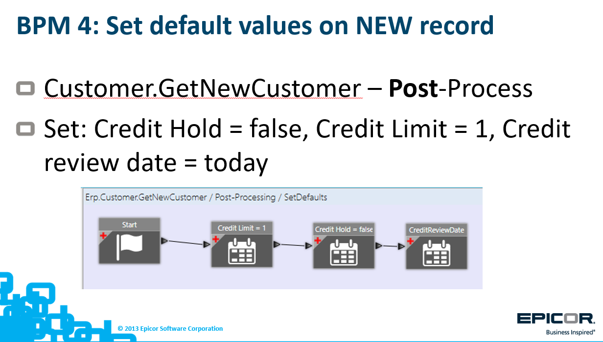

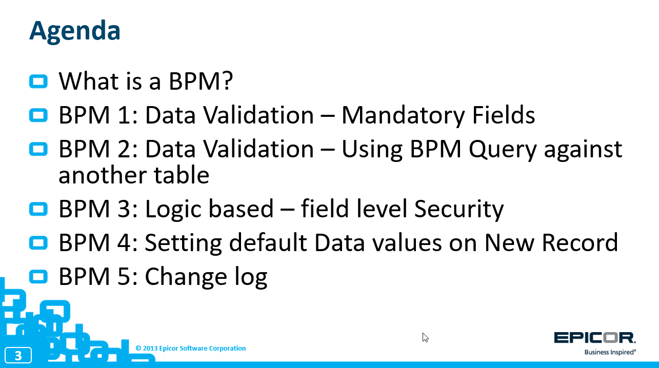

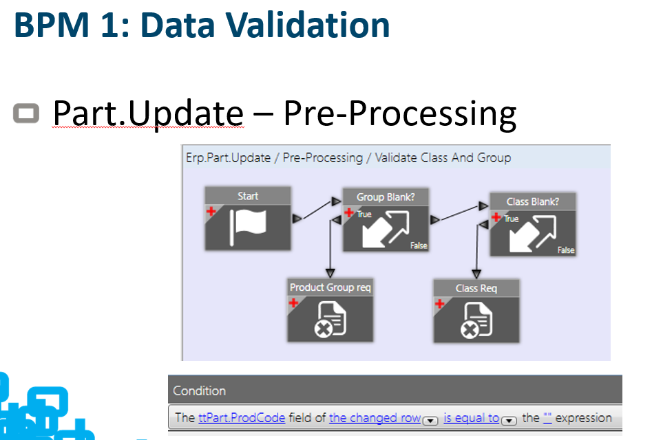

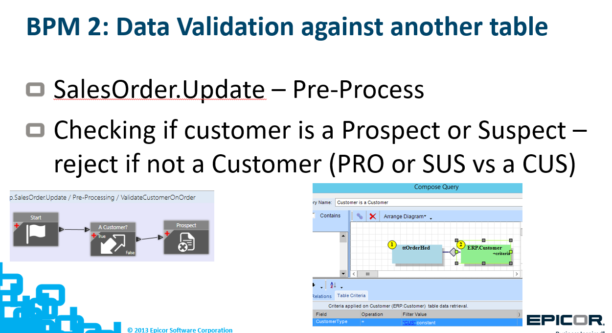

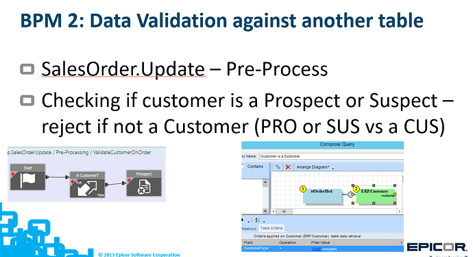

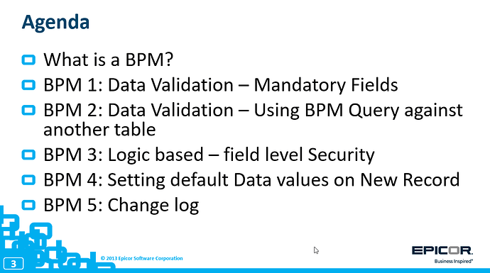

10 years ago I built a class called “Five BPMs every consultant should know how to create”.
Here was the agenda:

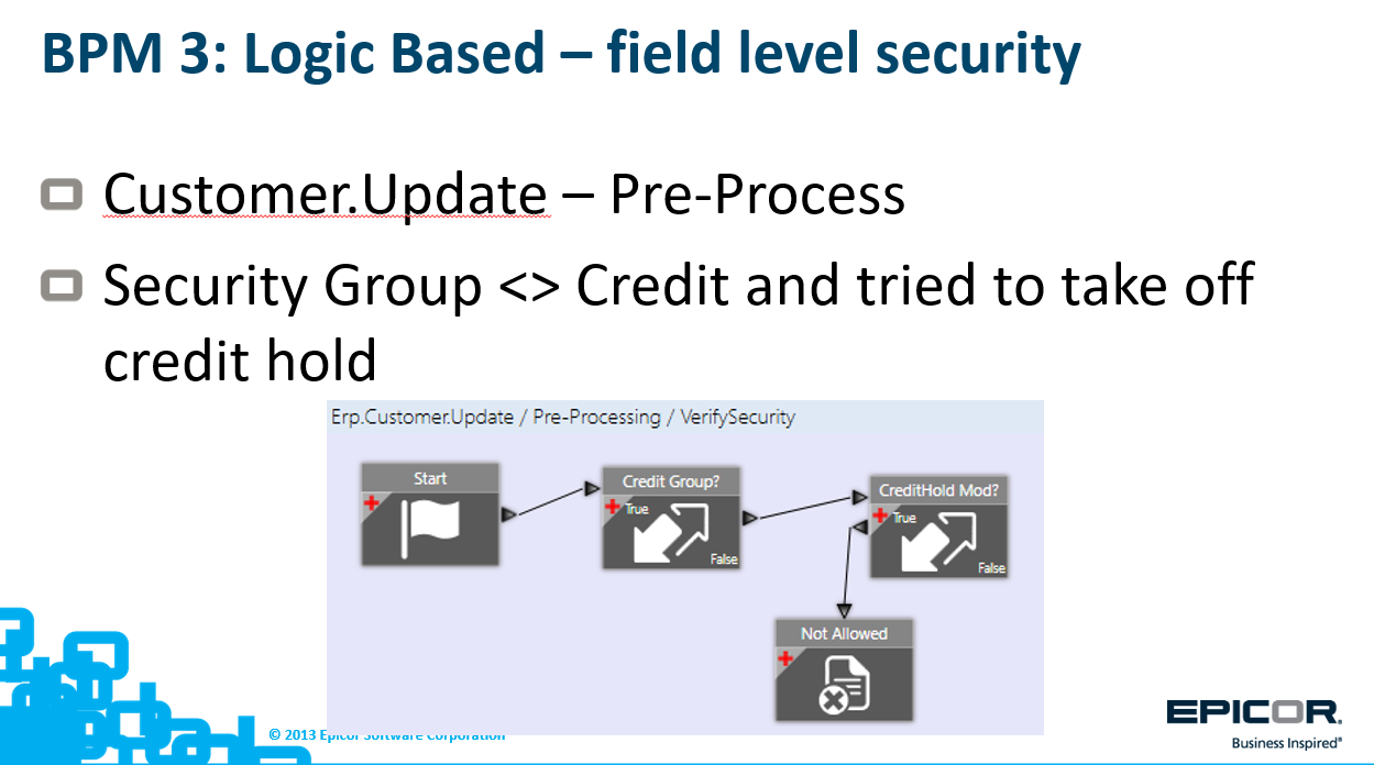

Here are the main slides:

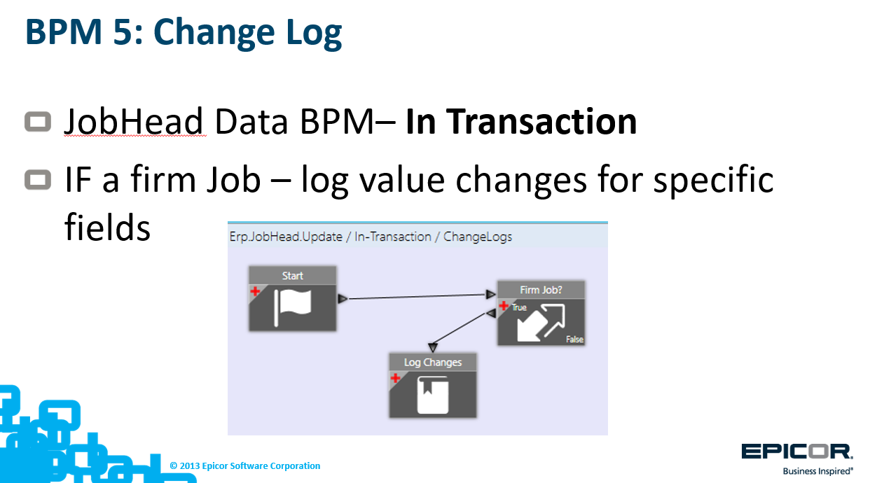

Main lesson on the next slide… do not do change logs without a condition… in the case of Jobs… only log FIRM jobs, because if you dont, then MRP will create change log entries for all sorts of things, and your change logs will be huge.
