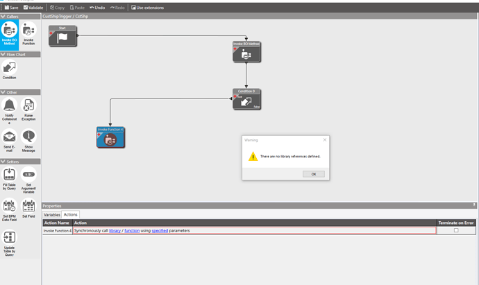

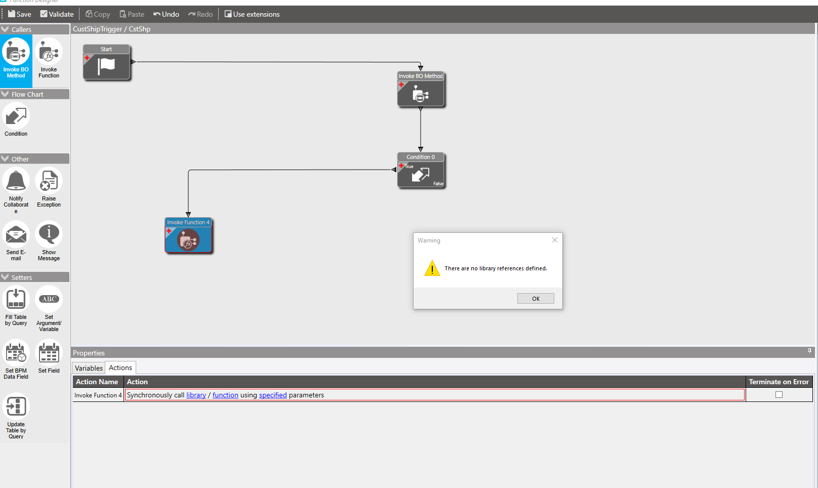

UPDATE: Figured it out! Had to add the library under the Reference tab. :person_shrugging: :pensive:
Can you lead to the info on how define the library? While trying to invoke the Function, I keep getting the error There are no library references defined.
I have the OrderLibrary being called inside the CustShip Function. I got to thinking, though, how is the correct parameters passed? Example: OrderHed.OrderNum=ShipHead.OTSOrderNum; OrderHed.Custnum=CustShip.CustNum, etc.

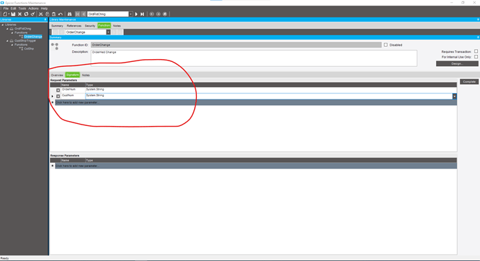

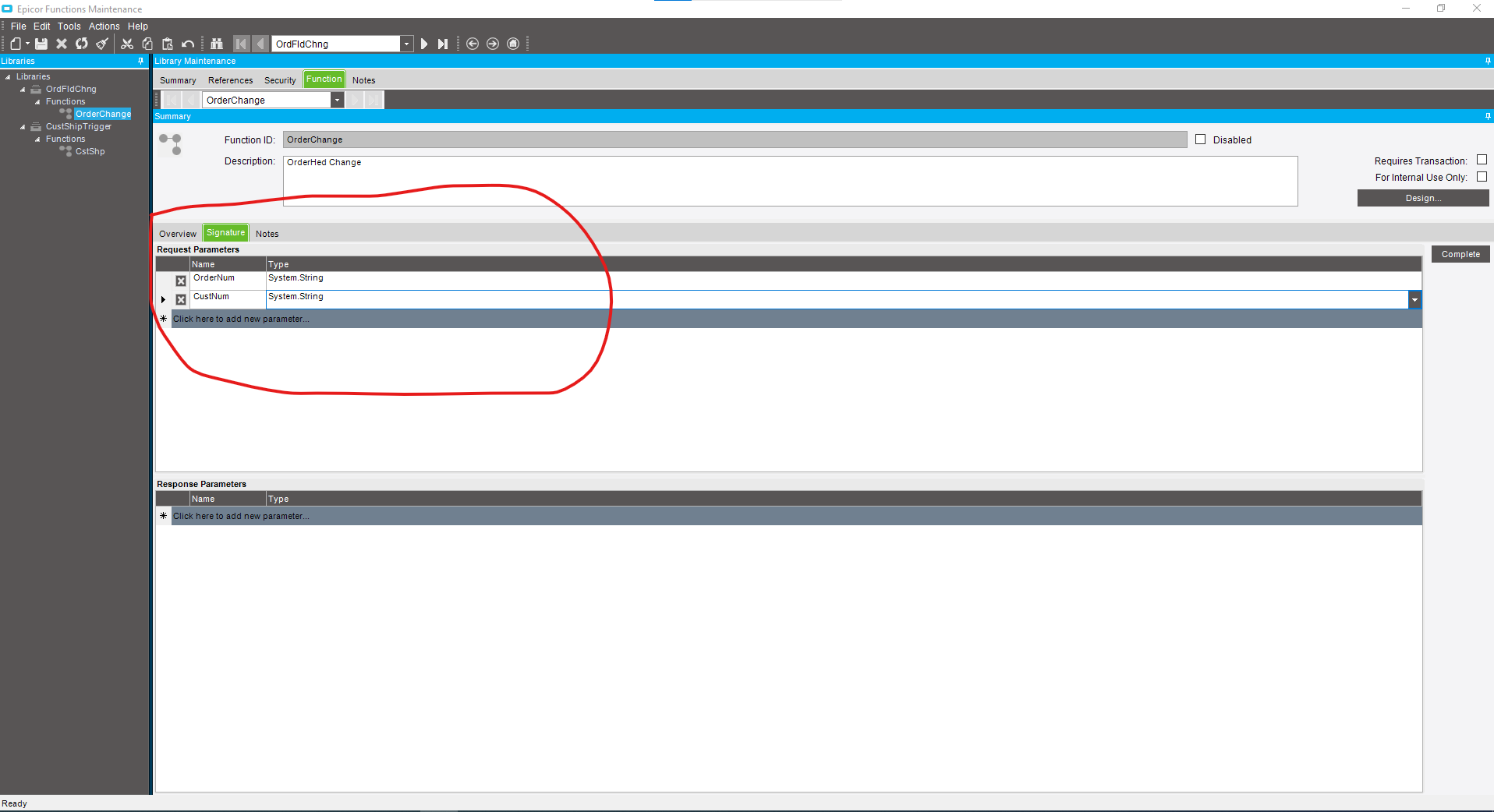

When you setup your function signature you define the parameters (input) that you want ot pass into the function then on the Widget in your BPM (or the other function) you should have the option to setup / pass in those parameters.
That is what I was wondering. Didn’t know if I put it in the OrderChange, if it would give me the option in the CstShp Function. Below is what you are referring to, correct?
Correct.
Thank You!
