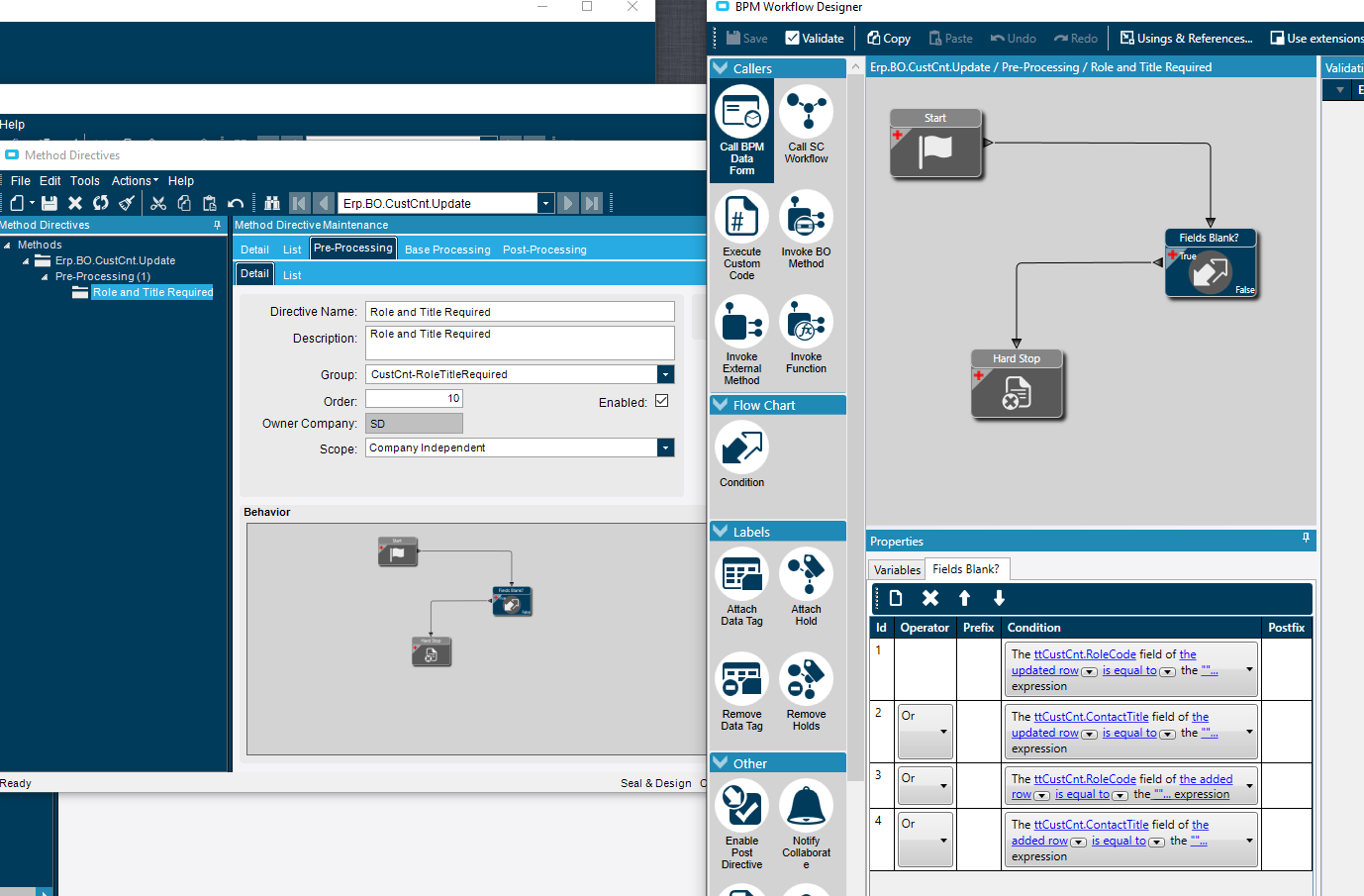

I’m trying to create a simple BPM against Customer Contacts to make sure the Role and Title are filled in before saving new or updating contacts.
It does as it should, it pops open the exception box. It prevents saving unless those fields are filled in.
However in the case of the adding a new record, it completely deletes all the user input after I click ok on the popup. I’m hoping it can just stop the saving and then go back to the form so the user can add the missing info. As it is now, if they click save and have a lot of information filled in, the end user would have to re-enter all that info and that’s very bad UX.

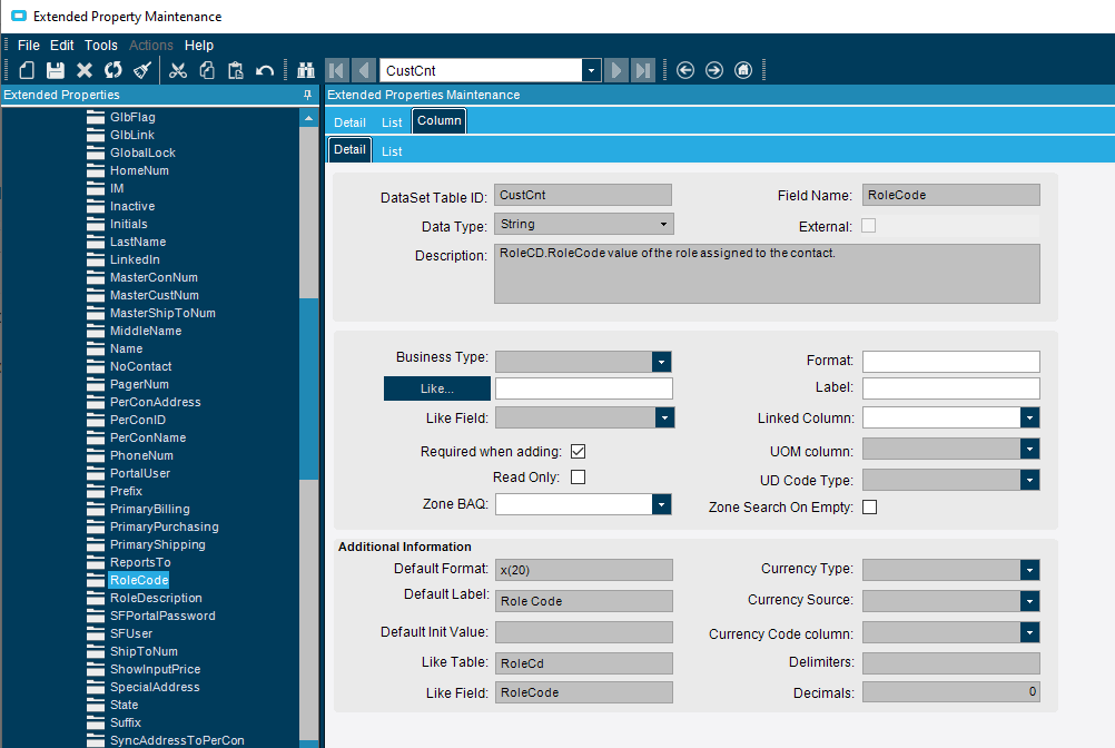

Another approach may be making those fields mandatory in the Extended Properties of the table. :man_shrugging:
That is my go to for making fields mandatory over a BPM.
I tried adding the requirement to the Extended Properties.
It behaved the exact same as my BPM, it deletes all the input as if you didn’t even start adding a contact. That’s the Epicor behavior I need to prevent. I can envision my users entering a bunch of info without role and title and then saving and it deleting.

So, you are going to have to trace the transaction to see what method is being called after you click OK. Once you know that, there should be a way to bypass that method from running.
I feel like this is one of those times where @klincecum chimes in and says: Oh here’s a link to a custom function library that I built for just this type of thing… it writes all the field names and values to a textfield and then programmatically re-adds the record with all those values already filled in.
In all seriousness, though, I was hoping it wouldn’t come to that. But if you had to, you could enable a post-processing directive and then add a new record back with all the values saved from the pre-processing in the callContextBpmData and then re-add them in the Post-Processing BPM after you enter the new record. It could work.
Another option could be instead of a hard stop use a BPM form to have the user enter in the Role & Title, then that data can be passed back and saved. This way the entered data doesn’t get lost and the Title & Role fields entered.
Just thought of this, what message format are you using? Is it the error or another one. If it is error, you may want to just change that to a standard message box.
That’s a great suggestion! Gives the user the opportunity to fix it instead of the hard stop.

I used the Extended Properties and set it there.
The users were not exactly happy with the behavior but will deal with it.
